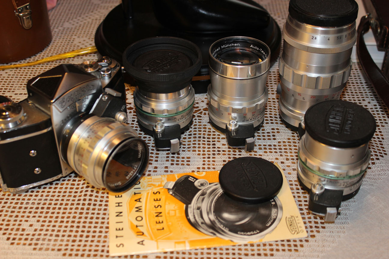

I have 4 exakta's and a complete set of auto steinheil lenses 35mm 55mm 100mm 135mm 2.8 135mm 3.5 all restored and clean I don't use them much I don't like left handed operation. but nice camera's.

my exakta set
Complete steinheil auto set all in working condidtion
That's a nice collection. The VX1000 set in the Classified forum also has some nice lenses. Were it not overseas, I'd be interested.
