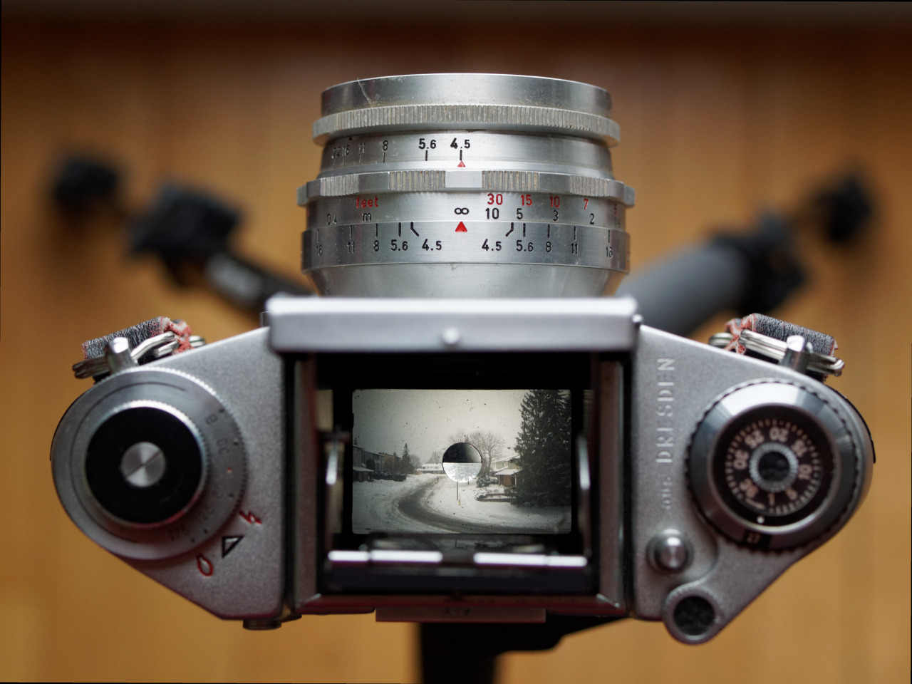

MattKrull
Sep 2, 2013
311
Ottawa, Onta
attachment.php

Very nice!

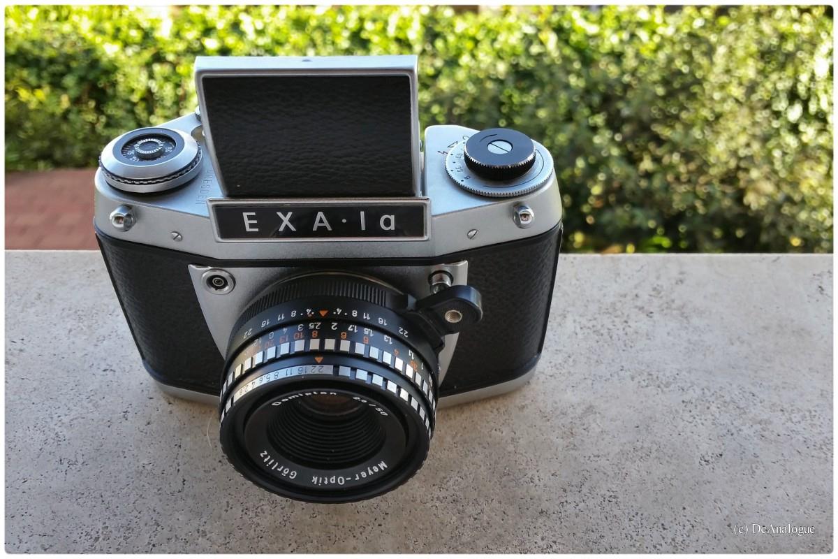

My Exa Ia
Here's mine..... She's lovely and works well..... ;-)
attachment.php
Soon il post the first roll on my Film Blog

AgX
Apr 5, 2007
29,972
Germany
Those Exas rather deserve a sound file, than a photograph...
