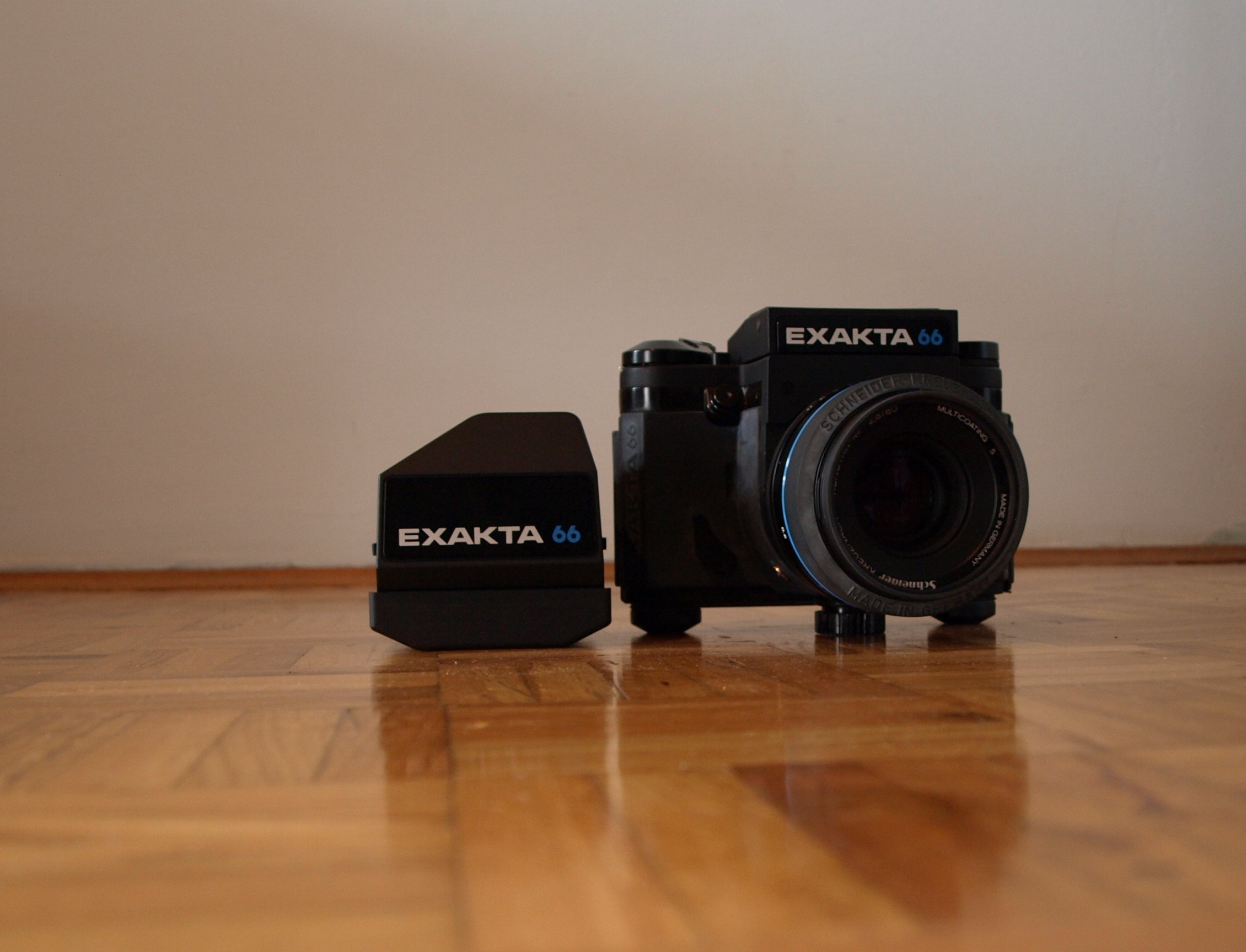

There you go ! Its a beauty.

There also is a Exakta 66 built in different versions from 1939-1954!
The new Exakta 66 is based on the Pentacon Six and their original parts. Except for:
-) a new shell
-) new groundglass
-) prism- and hood finders
-) later samples got mirror-lock
-) lenses are from Schneider-Kreuznach (with preset-aperture link for metering)
Ian Grant
Aug 2, 2004
23,417
West Midland
The problem with the Penatcon 6 is poor build quality which was the case with most Praktica cameras so some aren't very reliable with poor spacing. The West German Exacta 66 was made from mostly Pentacon 6 parts but where necessary the weaker parts (in the design) were replaced which resulted in a more rugged reliable camera.
You may see little or no difference in images made with the two bodies.
Ian
jspillane
Aug 2, 2012
240
Brooklyn, NY
If both are in good working order, you shouldn't see any difference in the images (since they take the same lenses). The Exakta 66 is better made and somewhat rare, thus the higher price tag.
