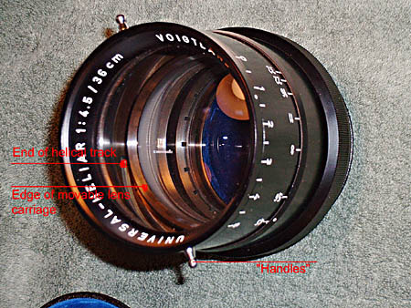

Steve, What actually takes place when you turn the defocus ring. The heliar has 3 groups. G1 G2 are usually together in the front with G3 in the rear. When you turn the defocus controller what gets seperated from what, and by how much. Wondering if I can accomplish the same thing with my "ordinary" Heliar.
My understanding is that the defocus ring moves the third element in the middle.
David is correct; the center element, which is in front of the iris, moves back and forth.
Attached is a pic of the Universal Heliar I made when inquiring about mounting it into a Compound #5 (Not!). I think this pic has enough resolution to show how it works.
Steve

Steve, it looks like it moves quite a distance in there with that big helical. How much, and which direction. Of course I'm trying to accomplish the same thing with mine by removing the group, turning the rear out a few threads, and re-assembling leaving the front out the same distance as I added between. Looking at yours does that seem possible, or is it moving 1/2 and inch or something.

I measured the movement, and it's approximately 7/8" - 15/16. Zero position (no diffusion) is back against the iris, and the #5 position (maximum diffusion) is 7/8" forward towards the front, or subject end of the lens.
