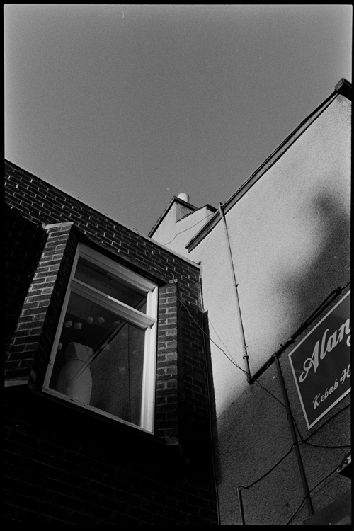

Hi,
Thanks all for the replies. I appreciate you probably need to know more.
The increased density I am speaking of is always around the edges of the frame, and occurs in bright areas like skies and strong highlights. I have attached an image where I have lowered the exposure and increased contrast to make the issue more apparent.
The issue occurs across several cameras, all of which deliver perfect rolls of colour film when sent to the lab i.e. this is not a light leak issue. Most people have suggested insufficient agitation.
Keen to know anyone's thoughts!
Cheers

The problem is in the negative scan.
The lighter pixels extend not only at the side but at the top. RGB values for the sky: Left side 175, right side 175, top 140, middle 110.
If this were an agitation problem the left an right sides would not have almost exactly the same degree of lightening and there wouldn't be lightening across the image at the top between the frames.

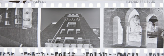

As has been already requested, can the OP please supply an image of the neg strip, something like this.
MattKing
Apr 24, 2005
53,130
Delta, BC Canada
I need to make and keep at hand one of those examples of a negative strip for just this purpose!
I think I'll make one for 120, so we have variety!
