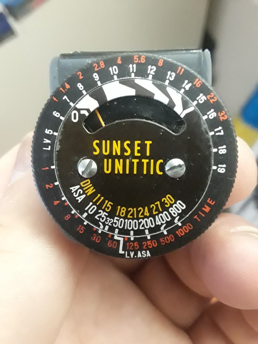

Thru a happy coincidence, I just received this cute little bugger in today's mail. It is a selenium meter, so from the heyday of the EV/LV period.
Note that the Exposure Value scale is labeled LV, and the film speed selection pointer is labeled LV . ASA.
