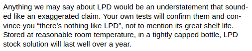

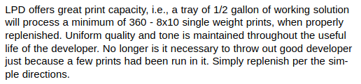

Here are Ethol's claims about LPD, taken from https://www.digitaltruth.com/products/ethol_tech/ethol.pdf :
@Milpool is correct: It appears that the "L" in LPD assumes you are replenishing. That's misleading because all developers last longer when replenished.
In the second paragraph, they claim that the stock solution (concentrate) lasts a long time. But that's also true of other developers.
