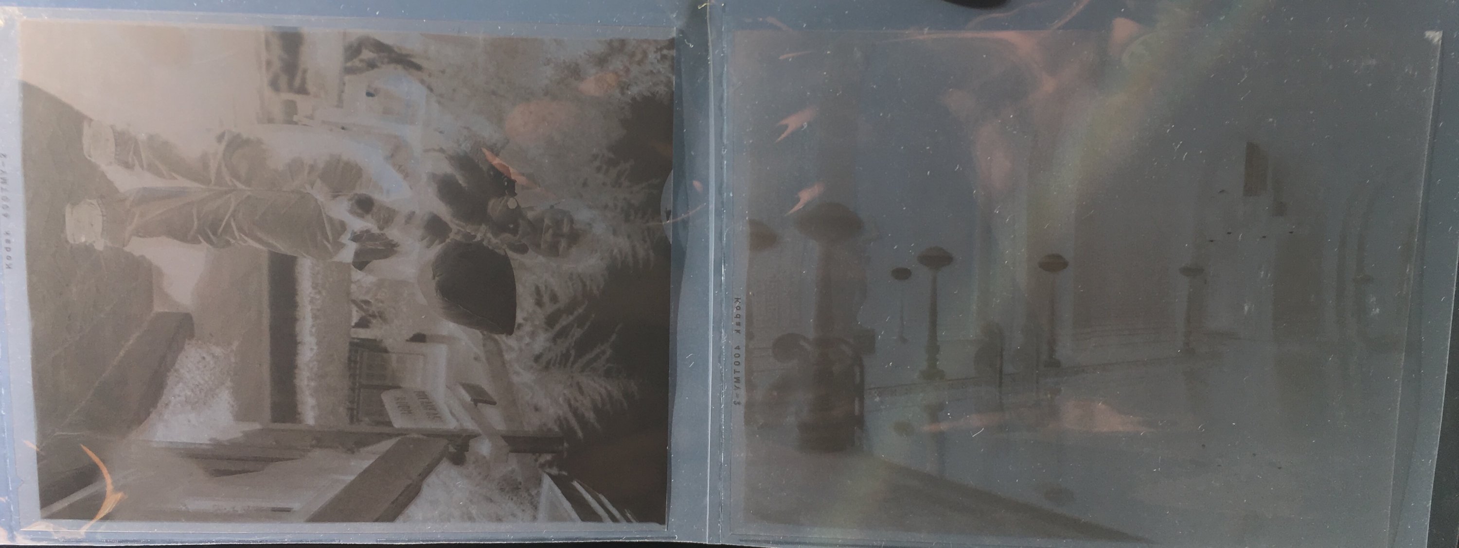

These are the two negatives that sealed my fate. It was the craziest short-circuit. A “throw it all out the window” revelation.
About 8 years ago I was making prints from summer vacation. I looked back over my prints and found myself pretty happy with all I had done.
Then it hit me. These two negatives were bears. I knew the Hearst Castle swimming pool was barely given enough exposure because they don’t allow tripods. I developed it as long as I could but my wife called me to say we were late to dinner with friends so I had to plunge it in the fixer before I really wanted to. It barely makes a good print on grade 3 Galerie.
The other negative obviously has my son carrying his pillow in bright sun. Developed normally, exposed generously. That bulletproof negative stretched the limits the other way. Just a tad of burning the texture in the pillow can be faintly seen in the grade 2 Galerie print.
At once I knew... those prints made me happy but I never wanted to have to deal with a thinner negative or a more contrasty negative. I call them my Upper Control Limit (UCL) and Lower Control Limit (LCL).
Done. Now to put it to numbers... 0.86 = LCL and 1.18 = UCL.
Aim for the middle, call it 1.00 and give a tolerance... I aim for density range of 1.00 but know I can deal with anything between these two limits.
That's quite a lot of tolerance. So when it comes to developing film. I figure I can make a 30% mistake and still not ruin the negative.
