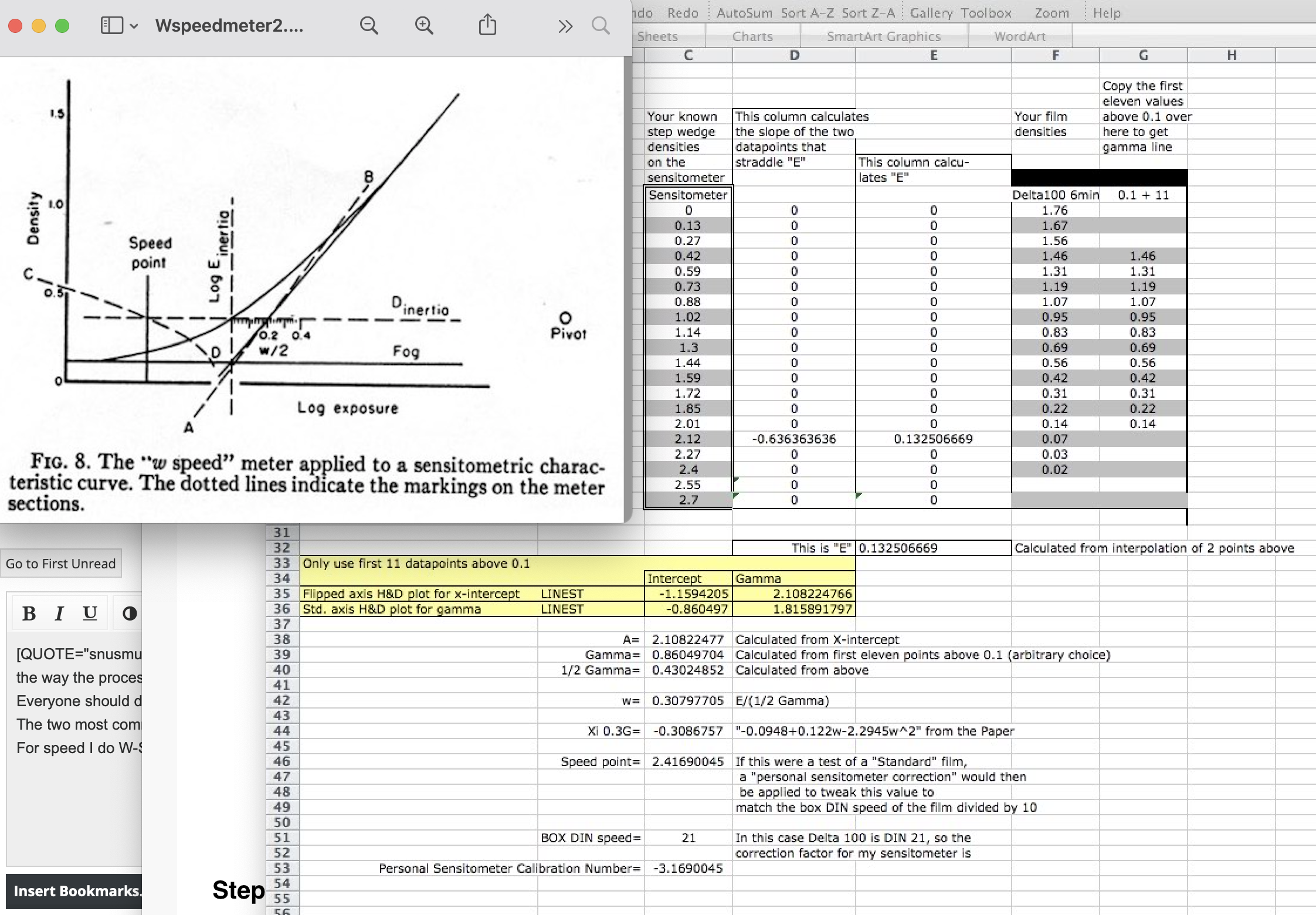

Everyone should do the Kodak Sensitometry Workbook PDF, it is free on the internet.
The two most common math functions for the H&D curve are contrast and speed.
For speed I do W-Speed and ASA (ISO) speed with a spreadsheet which calculates the data. Also popular is Delta-x speed but I found it harder to program that one.
This is a screen shot of my spreadsheet and a picture of the old-fashioned protractor used in the initial papers.

The output of my spreadsheet gives a contrast index, 0.1 point, ASA triangle, W-speed and safety factor.

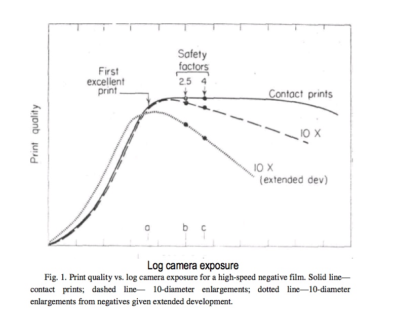

I don't shoot slide film any more, but there is a much information on exposing slide film out there too (where the shoulder is used for speed determiniation. In that case the sensitometer exposes a complete shoulder, and does not fully outline the darker parts of the curve.
If you are interested in the shoulder of negative films in terms of image quality, that has been explored in depth also. Lots of interesting stuff out there! Most of the articles need to be paraphrased to be shared, unless they are really old. Those in school, may have access to papers on -line for free through the school library.
BTW this does not show the shoulder, just its effects. That is as soon as the highlights get onto the shoulder, print quality diminishes.

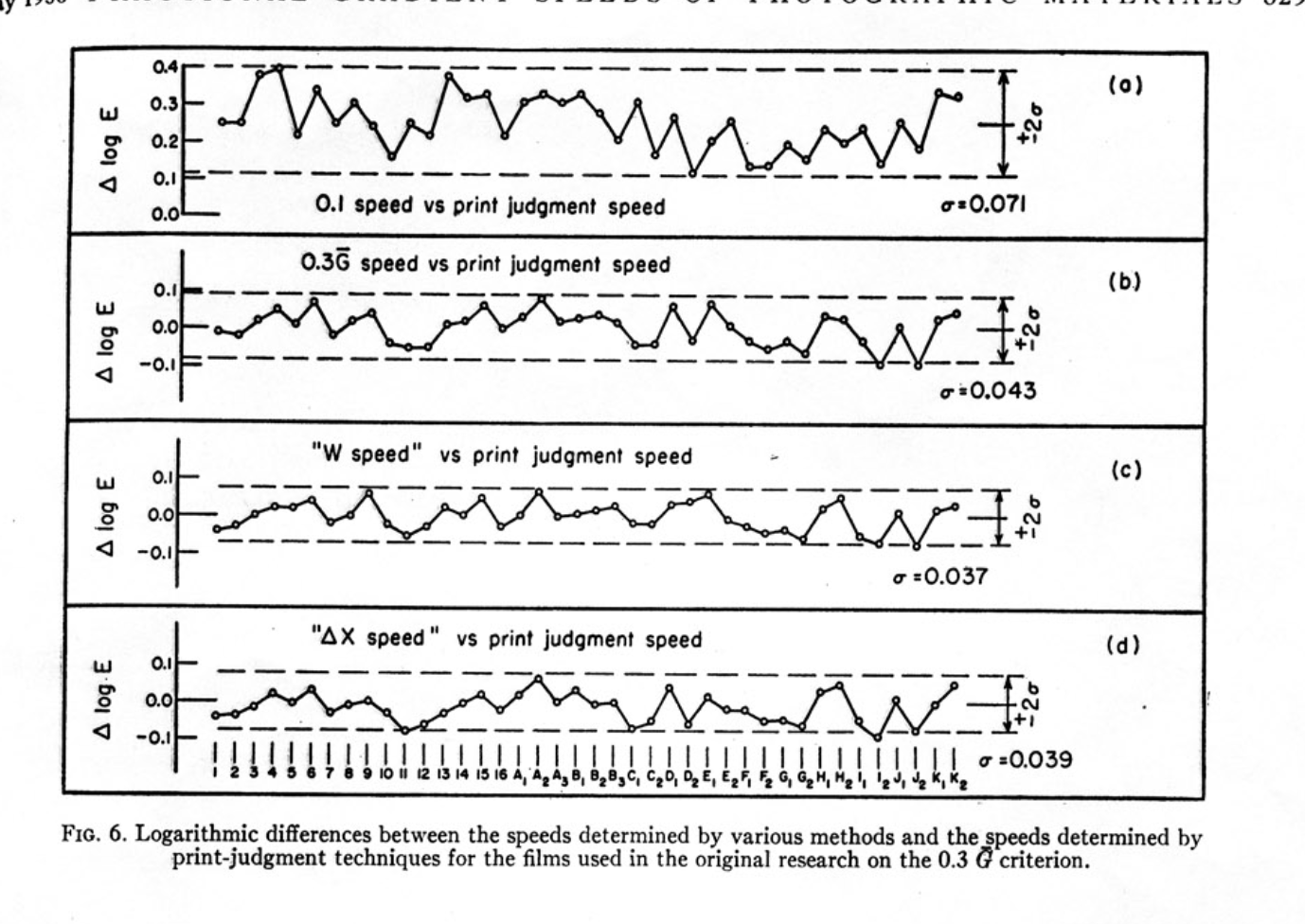

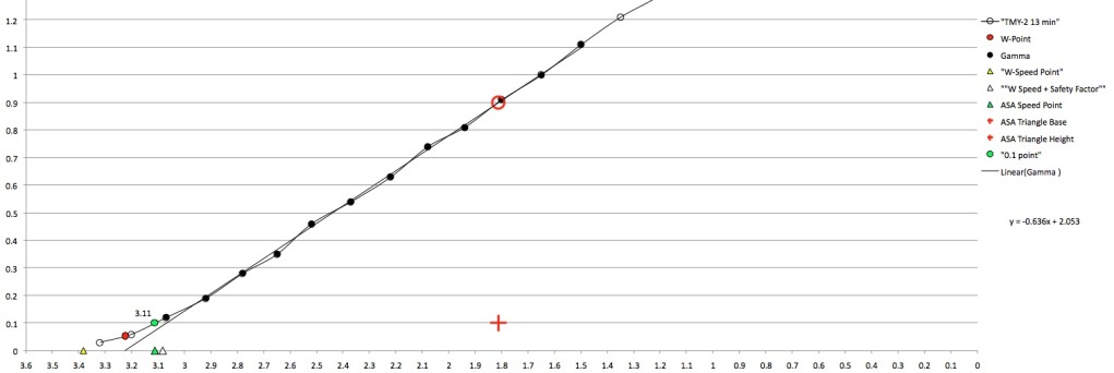

A quick little history.
To find the speed of film researchers Jones, et al 'discovered' that if the shadows fall on a part of the toe curve that is tangent to a line one-third of the slope, that was the minimum exposure for an excellent print. They made multiple prints and showed them to a panel of observers.
When they did this, there were no personal computers and this 1/3 slope or 1/3 G or 'fractional gradiant' was not so easy to find outside of using pencil rulers and paper graph.
So...three approximations of this 1/3 G (fractional gradient point) were developed that could be found on the toe curve without as much trouble or without a computer:
0.1
Delta-X
W-speed
The three methods were compared and found to be roughly similar in the approximation of 1/3 G speed point.
It turns out 0.1 was eventually chosen as the method to use by modifying it slightly to specify a certain slope the film needs to have (so called 'ASA Triangle') before taking the measurement. This became ASA and was nearly copied directly for the ISO standard and also embraced by many Zone system users.
This whole history of film curve analysis would have probably played out differently had computers been available.
So, as it stands ISO is firmly established, but it is fun to look back at how it came to be.
Realize that in all this research the GOLD STANDARD is "print judgement." Yes, objective viewing of the prints by a panel of observers TRUMPS ALL THE MATH!
