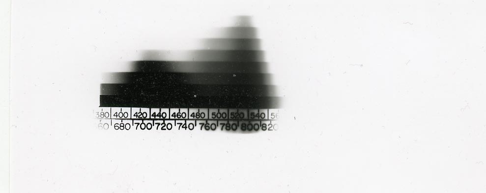

Ilford MGIV Spectrogram
Ok, I did this in my own lab with a spectrosensitometer.
2" exposure, Dektol 1:3, stop, fix and wash.
PE
