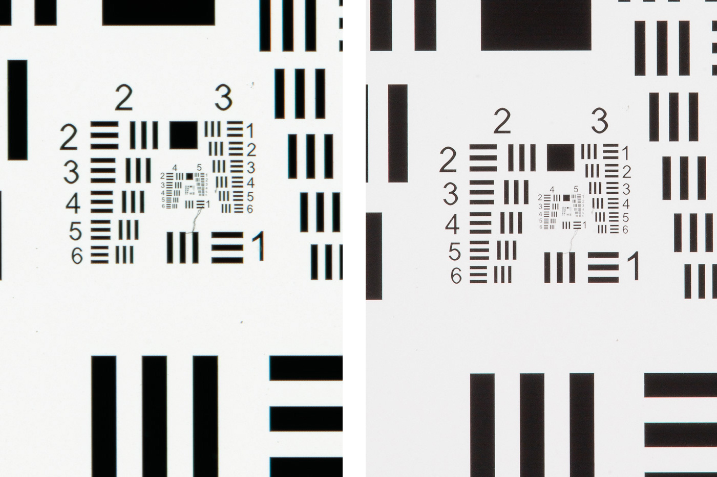

Not only that, the image from the V850 is very soft, I was surprised that I could see as high rez as around 2300dpi by seeing difference in lines in this softness. Reading resolution targets is only half the story. The 5DM3 shot has higher resolution (not much, forgot the numbers) but the image is clear and crisp.
5DM3 with 100mm macro on the right, V850 at 6400dpi on the left.
I printed those out and they look similar on print as on screen.
