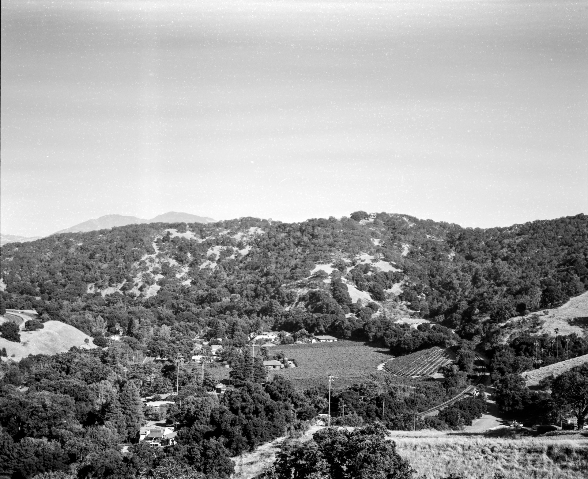

Developed my first roll of 120 Pan F Plus and scanned it, using both Epson Scan and SilverLight, letting the software use default settings.
The resulting digital files in Photoshop look disappointing—very flat and dull. Is this what I should expect, or are there settings on the scanning software to generate a scans that look more like the proof sheet? Or is this normal when scanning B&W negatives with the assumption that you need to use a curves adjustment layer in Photoshop to set the black level and contrast?

Please show us an example, so we can tell if it is the settings.
Here's the image with no manipulations in Photoshop.

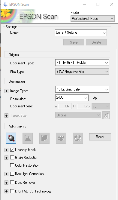

@SodaAnt since Photrio cannot support any file bigger than 2mb and no TIFF support, I cannot upload my example file. But my Epson Scan settings look like this. This is as basic/default as I get for B&W.
This looks like a fully usable, nice flat scan - easily and quickly made to look whatever way you want it to.
^-- Agreed. At a minimum, adjust the levels of top ends of the black and white spectrum, and this should bring some life to it. Granted, from the hills in the background, it looks to have been a hazy day.

I never use auto exposure. Epsonscan Auto tends to clip. I set the levels (black and white points) manually so that they're just to the left on the left side and just to the right on the right side. You can do this either in the scan program or in your post editing program and scan flat with no adjustments at all during the scan. Picture will look very flat and dull until you adjust levels. Then tweak with the other sliders after levels. I also uncheck sharpen for the scan and use my post editing program for those edits as well. Note you have to check on Configuration link on the bottom the then on the subsequent page uncheck any auto adjustments to scan flat.

Some very quick tweaks with "levels" and the "Local contrast" setting in Darktable, produces a much better image, with a few caveats-- there's what appears to be a light leak, there's waves in the sky(?) and a whole lotta white dots that were in the original, but not as noticeable.
Aside from the artifacts, it seems to be an OK first attempt. Personally, I don't let the scanning software do any sharpening, as I prefer to do it own my own in post. I also typically set the endpoints on the histogram to match the scan. Have you adjusted the height on the transparency holders for maximum sharpness?
