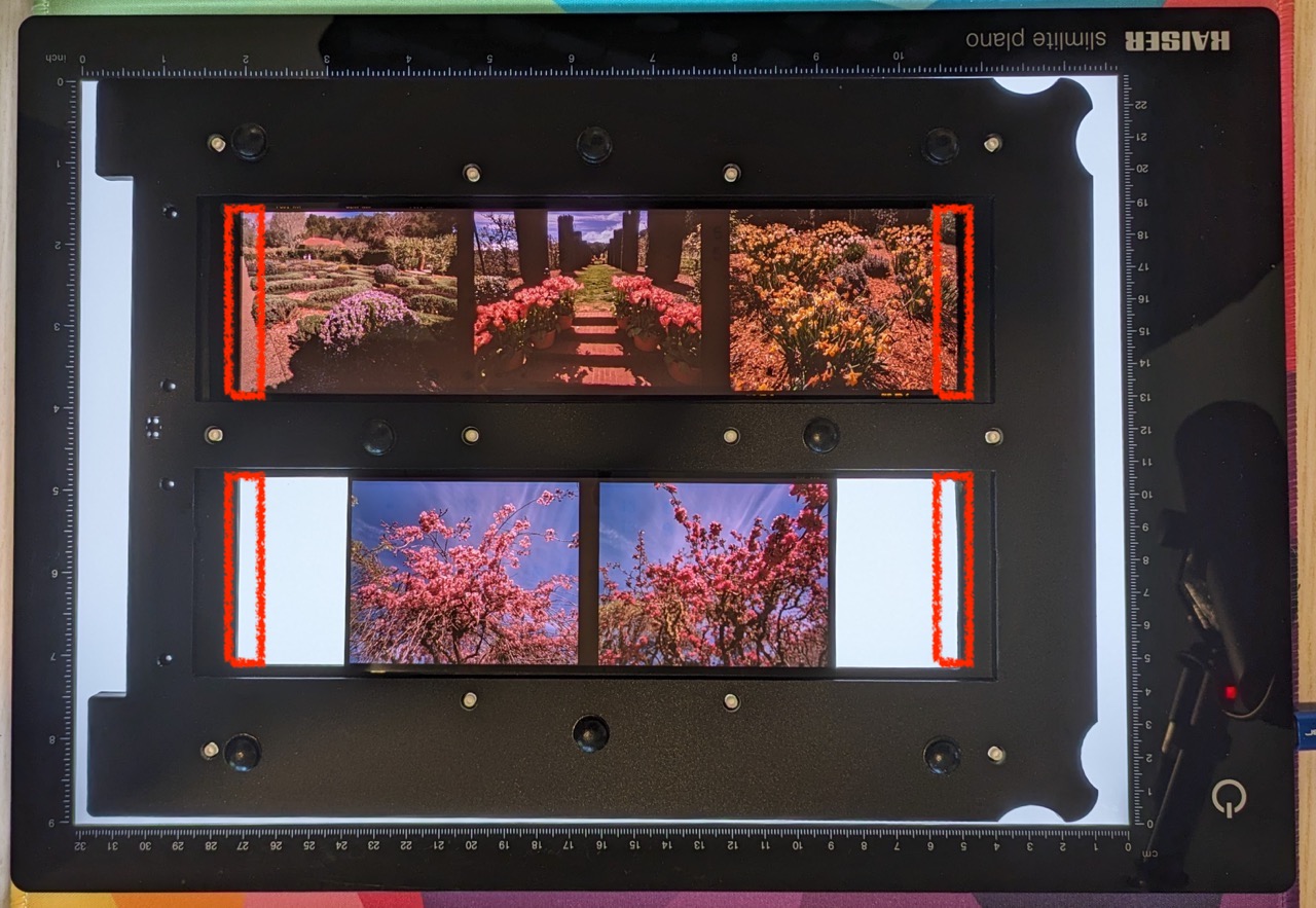

I have an Epson V700, which should be compatible to your V850 Pro in terms of negative carriers.
For 3 frames of 6x7, I hacked the Better Scanning carrier by widening it about 1/4" from each end (marked by red rectangle, using a file).
I actually bought a V850 120 carrier for its purported better flatness with the ANR glass. But I found it a bit fiddly, and only scans one stripe at a time. So I reverted back to V700's original 120 carrier, as long as the negatives are not overtly curly.
I only use the Better Scanning 120 carrier for 3 frames of 6x7 or 6x12 and 6x17 stripes.
