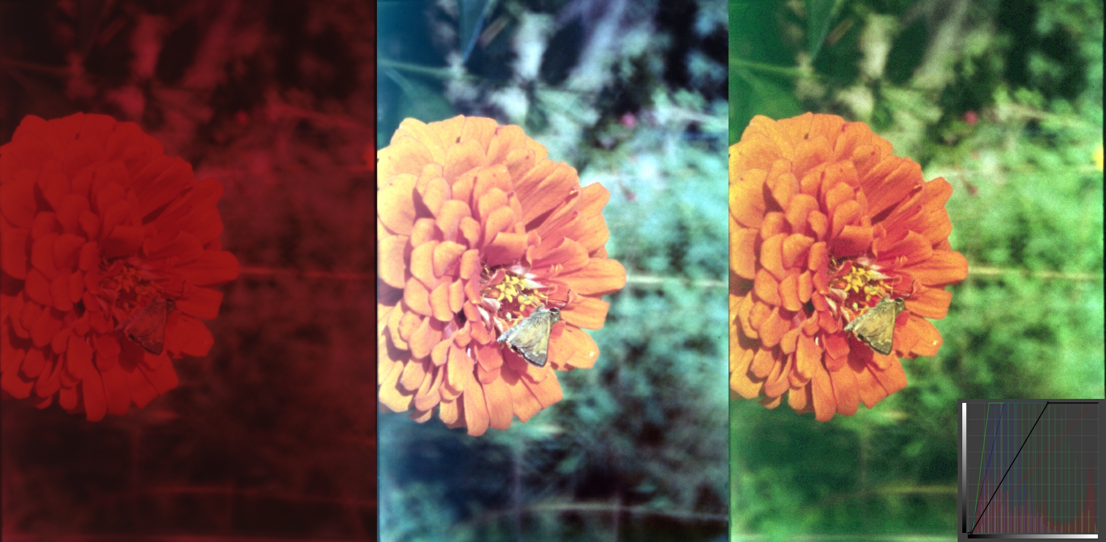

A full 8x10 holder for 16mm would be nice to have, but it sounds like some type of wet mounting would be an equivalent solution. Two 16mm strips will fit side-by-side in the V800/850 35mm holder, for a total of 60 frames in one go of mediocre film flatness. If you're lucky you can scan them as pairs of 35mm frames, otherwise get ready to draw little boxes or, more often, produce crops from a master scan.
The final of four 16mm cassettes of ektachrome I processed came out with a strong red hue but still scanned / auto-corrected well.
L to R: 'Raw positive scan; V800 default 'color correction'; manual curve adjustment of raw scan
