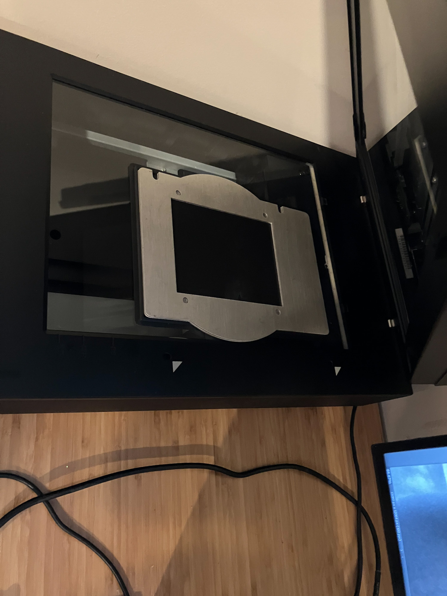

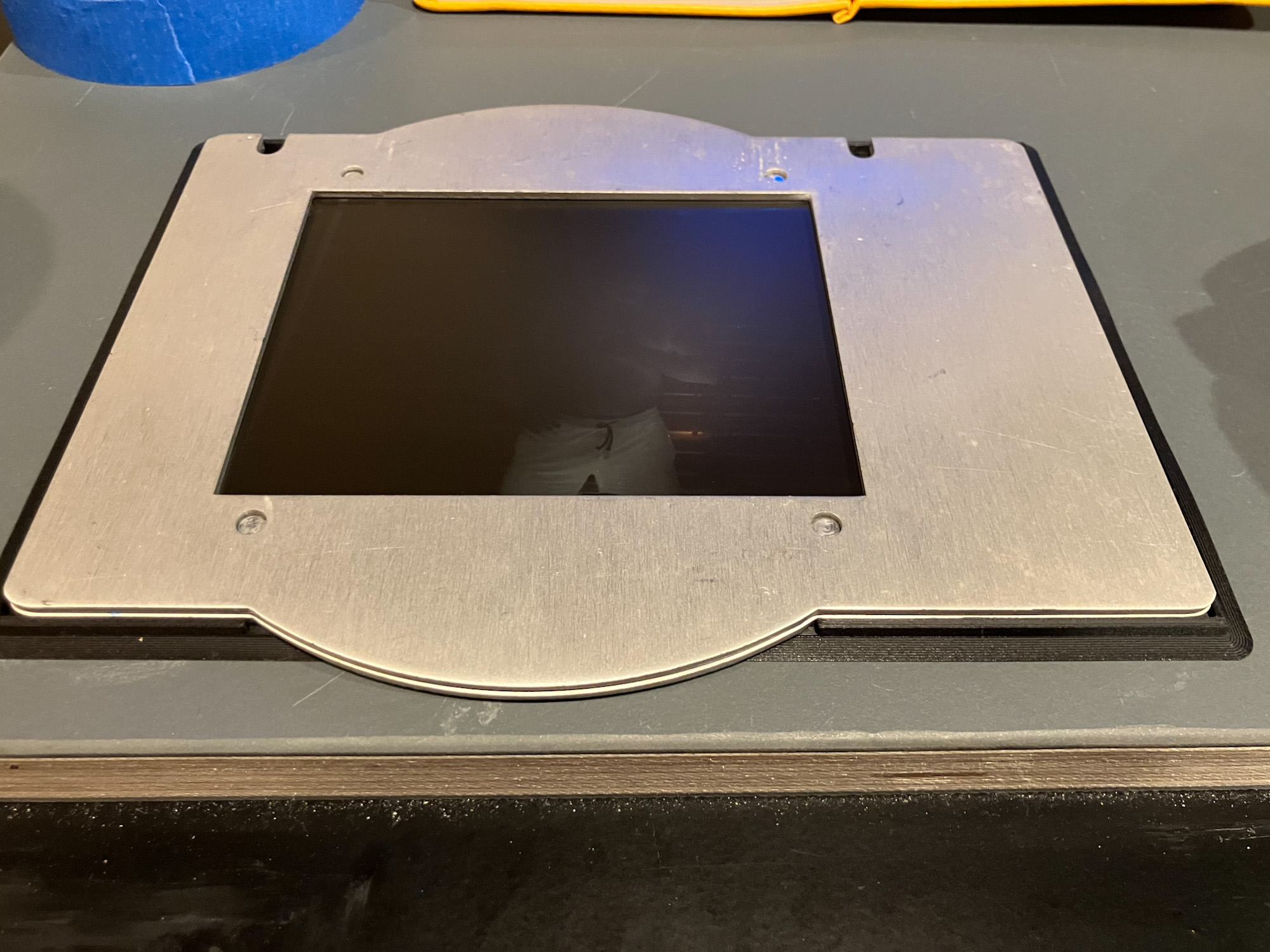

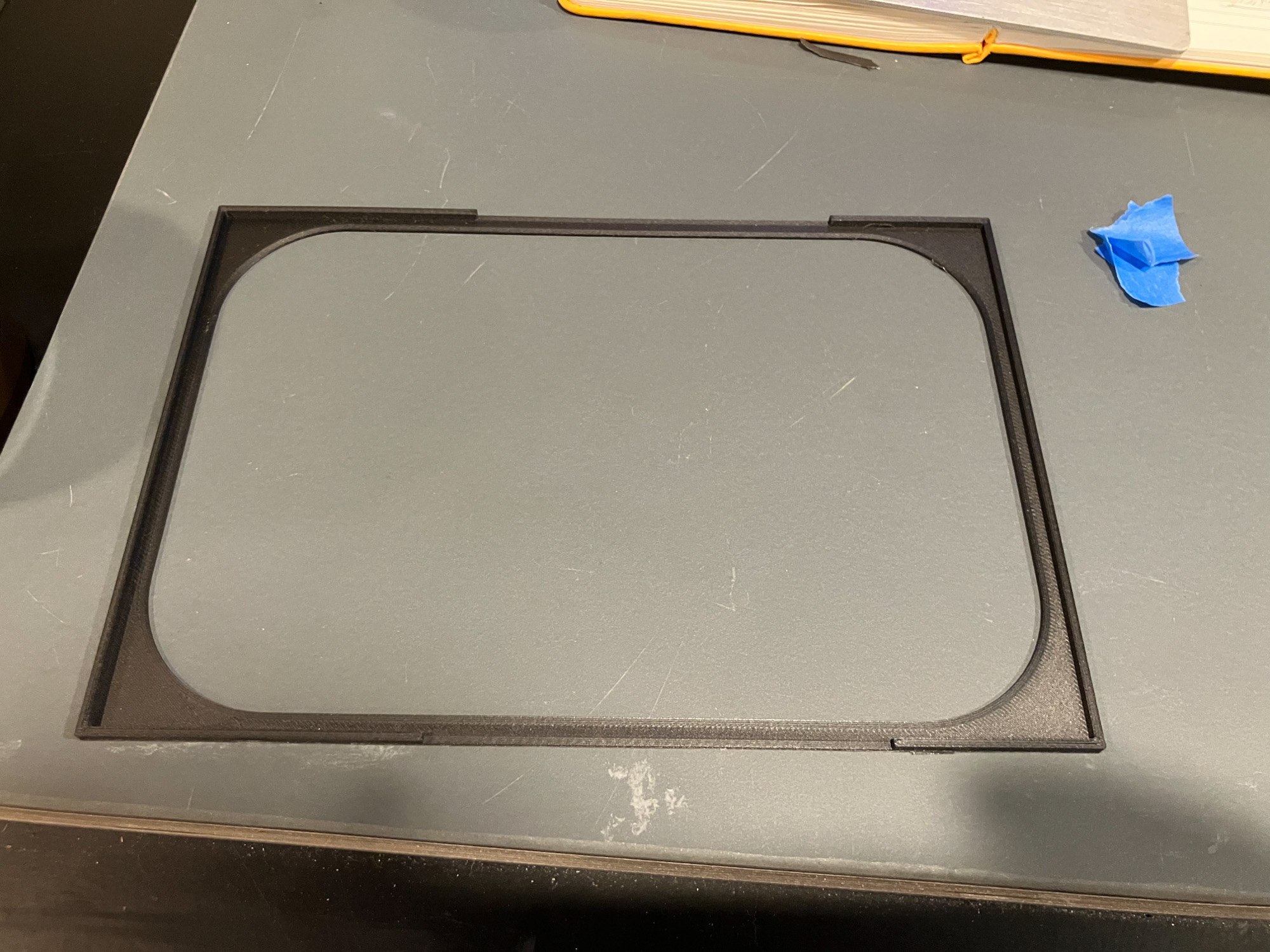

I use a process that’s pretty much identical to the one George laid out, but I still struggle with dust. I live in an old house with kids and dogs and my scanner is in the basement. There’s no escaping dust.
If I’m scanning 35mm, or a ton of 120 that I just want proofs of I just use the holders and clean them as good as I can.
But if I want nice scans I 3D printed a tiny shim that my Omega D5 negatives holders sit on that positions them at exactly the correct height for the scanner lens and just scan from that. Immeasurably nicer than the provided holders.
