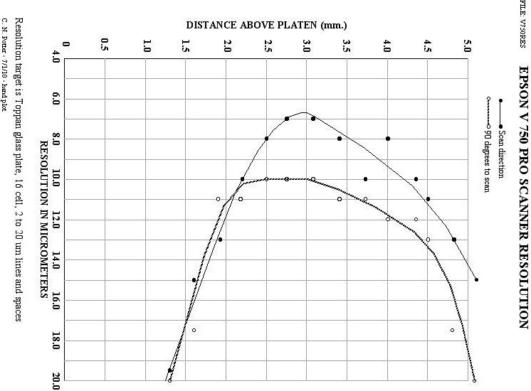

Betterscanning holders have a nice Pro feel. The Epson ones do the same but they feel like cheap plastic. If you have sharp negatives then your priority is film flatness and having ajusted the optimal height.
With only 1.5mm shift from the ideal height position you het half the resolving power in the best axis. blatbeds have an slightly lower resolution in the motion direction, but anyway any shift in the height end in a remarkable preformance loss, still this will only be noticed in very sharp negatives, many handheld shots are not perfect.
