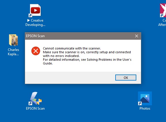

I'm setting up a new V850 scanner and I have a problem. Computer cannot communicate with scanner. See picture. I was having this problem on and off with the V600 and use to have to reinstall the program. But that doesn;t seem to work with the V850. The light is green on the scanner and I unlocked it with the two ship switches. I believe the computer is see the scanner because I have a program that check the status of everything and it see it in the report. I've tried different USB jacks. I'm running WIndows 10 64 bit Dell computer. Thanks for your help.

I've owned many Epson scanners on many computers and have never seen this problem. Have you tried another computer?
I started getting that at the end of a high resolution scan but the scanned image file was saved so I just ignored it. The problem may be with the recent Windows updates and we'll have to wait for Epson to catch up to Microsoft.
When I'm image editing Windows sees the computer as idle so background apps and services start running causing delays in the response from the computer including not reading the scanner as the OS is doing something else. A possible workaround is to disconnect from the internet when scanning or editing. Also check Epson's web site and verify you have the latest version of the software.
Verify your Windows installation is good: https://support.microsoft.com/en-us/search?query=sfc+in+Windows+10&ui=en-US&rs=en-US&ad=US
I called Epson in California and got connected to their expert in the Philippines. He was able to solve my problem. He had me delete the scanner in Device Manager > Imaging Device. I then uninstalled the program and installed it again from their website rather than the DVD that came with the unit. Also, you have to install the USB after the software is loaded and with the scanner power ON. Everything working now. Thanks all.

Correct. To clarify what happened (and I made the same mistake, even though I should know better)-- When you plug in a USB device, Windows scans for a driver, and if it can't find an exact match, it installs a generic driver. Then even though you install the Epson driver after that, Windows is still insisting on using the generic driver. This has been a problem in Windows since Windows 98 (or earlier).
By deleting the device and plugging it back in, you force Windows to re-scan the driver database while "getting your device ready". In theory, moving the USB connector to a different controller should force Windows to re-scan-- But the two front USB ports are usually on the same controller, so you'd have to switch from a back port to a front port, or vice versa (or USB 2.0 to USB 3.x).
So the rule is, always install the driver, THEN connect the USB cable. I have a vague memory that the instructions said plug it in, THEN run the software, but it was late at night, and I wouldn't swear to it.

Yes, that driver issue with WIndows I;ve had before. As an aside I tried try switching to the top USB ports on my Dell XPS desktop but that didn't make a difference. It required deleting the device and reinstalling the software, then plugging in the cable.
It is usually in installation manual. Install software (it will install driver), and only after it plug in, turn on device.
