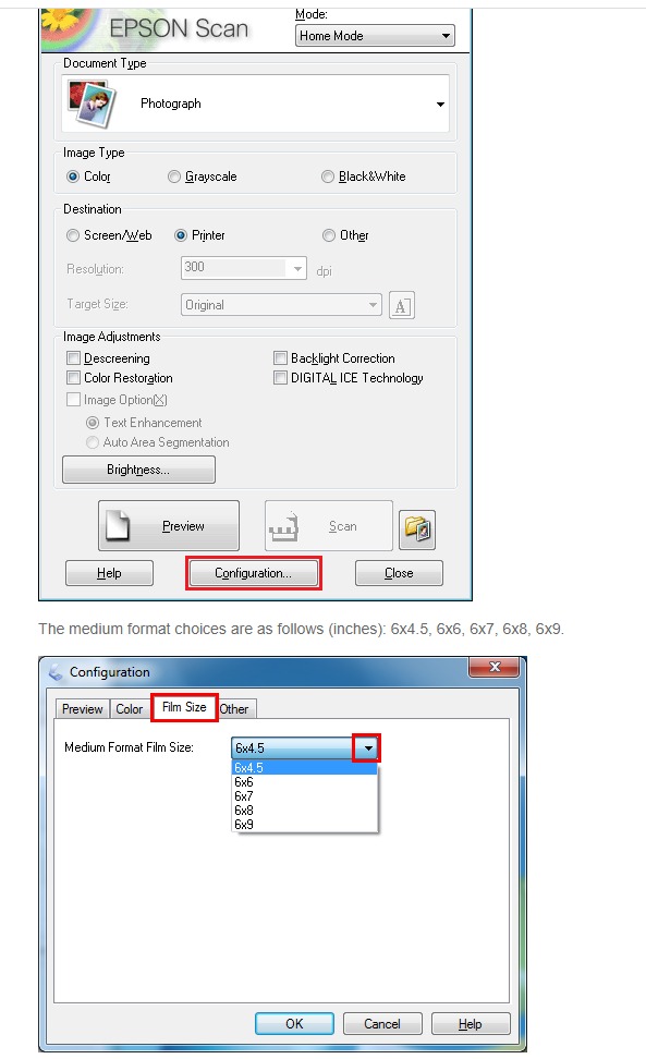

I don't use Epsonscan 2. However, my regular Epsonscan for Windows has a select box for the size of medium format films. 6x7, 6x6, etc. You click on Configuration at the bottom. Then, one of the tabs of the page it go to is for MF. There is where you select the size. Maybe that will help.
Here's a picture for this. First page shout be in Pro mode and for Film, of course.
