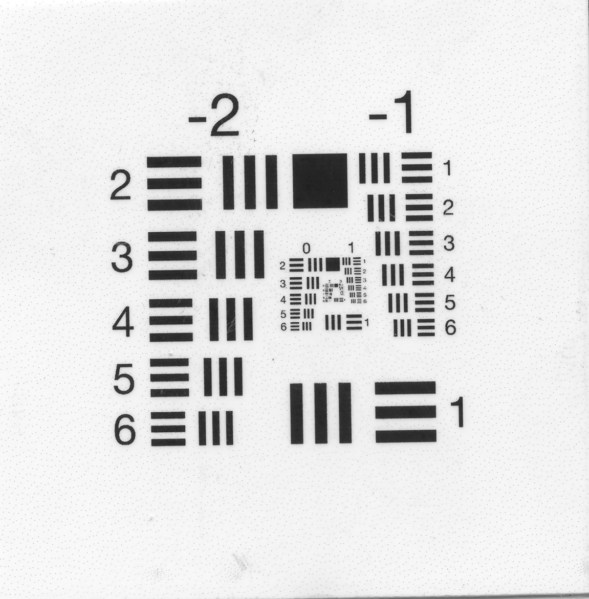

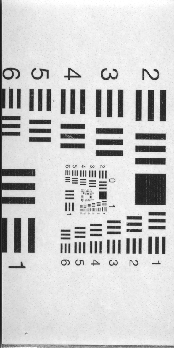

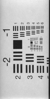

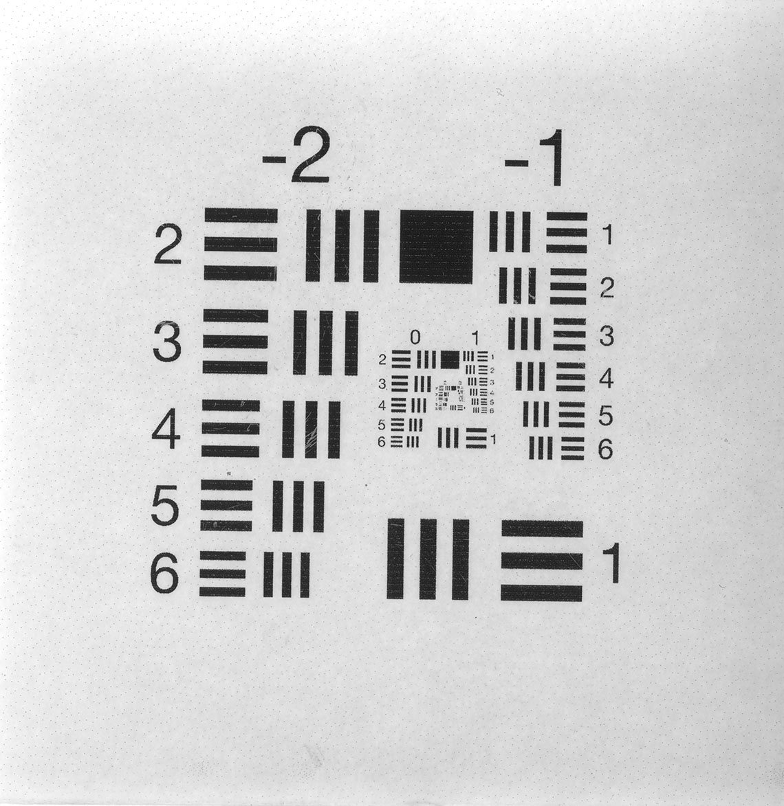

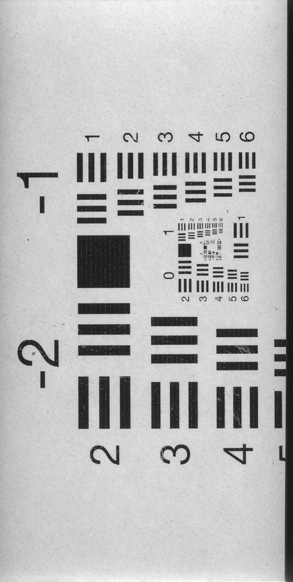

OK, it does not make a significant difference.
Epson V500, EpsonScan, 16 bit grayscale, 6400dpi scan resolution (scanner optical limit) saved as tiff then converted to jpeg in PS.
Left to right: target scanned as document, scanned as transparency positive with target on bed glass, target laying on top of film holder, target inserted as a piece of film in the holder. the target will not fit properly in the film/transparency holder.
Target is a 2 inch X 2 inch standard printed on Kirkland glossy photo paper on a Epson 2200 photo printer at 2800 dpi.
The bed glass on the 3200 is attached to the case with double sided tape. I have seen it turn loose and allow a side to drop slightly. To open that scanner start a scan then pull the power plug once the scan block has moved partway into the scan. Remove the lid by lifting straight up at the hinge. Remove the screw at the bottom of each hinge socket. Working from the rear lift the case off the base then unhook the snaps at the front and unplug the switch plugs. Assembly is the reverse. The scan block will be movable by hand as needed and will lock if pushed back to the home position. Assembly is more difficult with the scan block at the home position. The scan block will return to the home position on the next power on.
