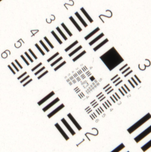

This is resolution target directly on the scanner glass bed:

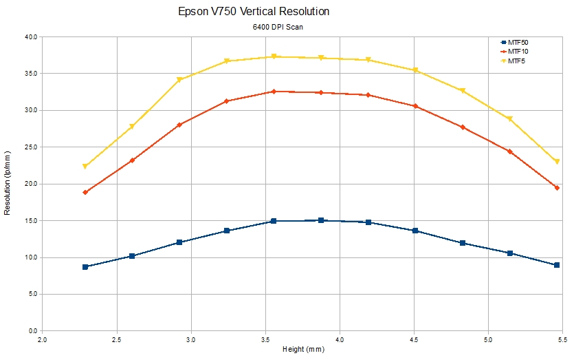

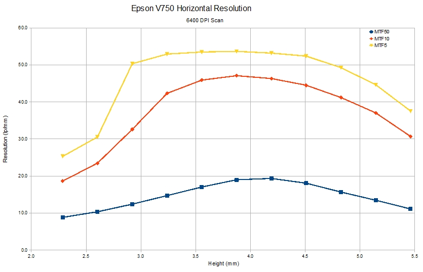

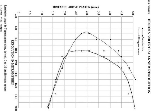

Tests made around for the V700-750 consistently show a peak yield at 3.5mm to aprox 4.2mm:
https://www.photrio.com/forum/threads/epson-v700-v750-focus-height-finding-the-sweet-spot.151784/
If film is curled up say 2 additional mm then a degradation effect may be seen (if shot is sharp), this is what the ANR solves.
Still it's not a bad idea to check focus, with the new V800 adjustable holdes it's quite easy to check it.

The V700 is usually well focused at the nominal distance, but film can be more or less curled. New V800-850 have holders with adjustable height, but if the curling goes up then the ANR glass puts the film in the right position. Height adjustment is more for curling than for optic correction, IMO.
Anyway at least the V700 can be manufactured with lenses targeting focus in then planes the mediums should be, it is not case of the 4990 that targets a compromise for two distances.
View attachment 241641 View attachment 241642
0.1mm of height change makes a difference on these scanners. You are showing something that cannot be applied to every sample produced, except by chance. This is misinformation not help.
There is only one fact about focusing plane for these scanners ... it needs to be set on each machine separately. Factory did a mass job getting most samples in some ball park, hence most give initial results not in line with expectations or claimed capabilities.
If you check "Through Focus MTF" graphs posted in Post 18 result is optimal across 0.5 mm interval, which I belive it's right in practice.
Some manufacturers of wet mounting holders showed graphs like this one:
But this is a cloud of spots and a synthetic curve generated by some software, I don't guess this is real in practice, but it may help to sell holders.
IMO V700 scan is optimal if film is placed in a 0.5mm interval.
