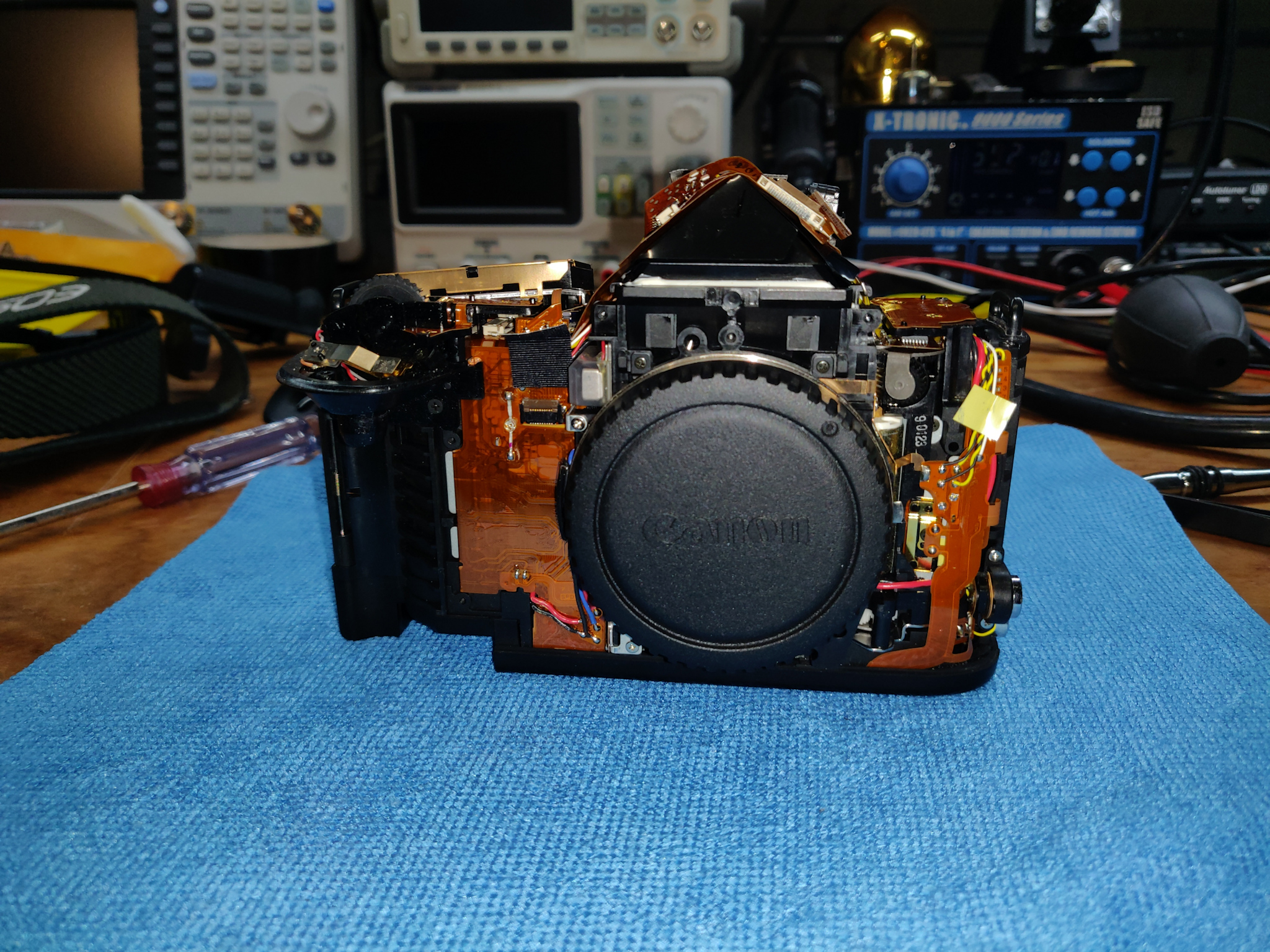

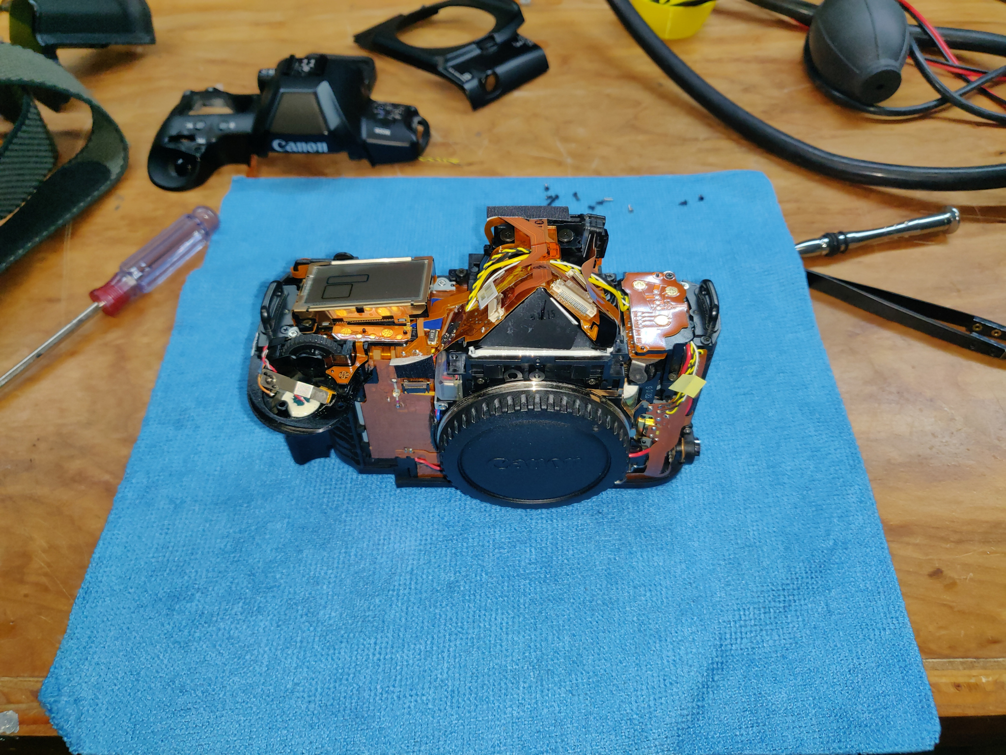

I decided to go into my camera just to see what I could see. I cleaned and reseated all the flex cables but to no avail, still has it's issues. so now I'm on the hunt for a replacement.
View attachment 332215View attachment 332216
I think it is time to pour one out for your homie.

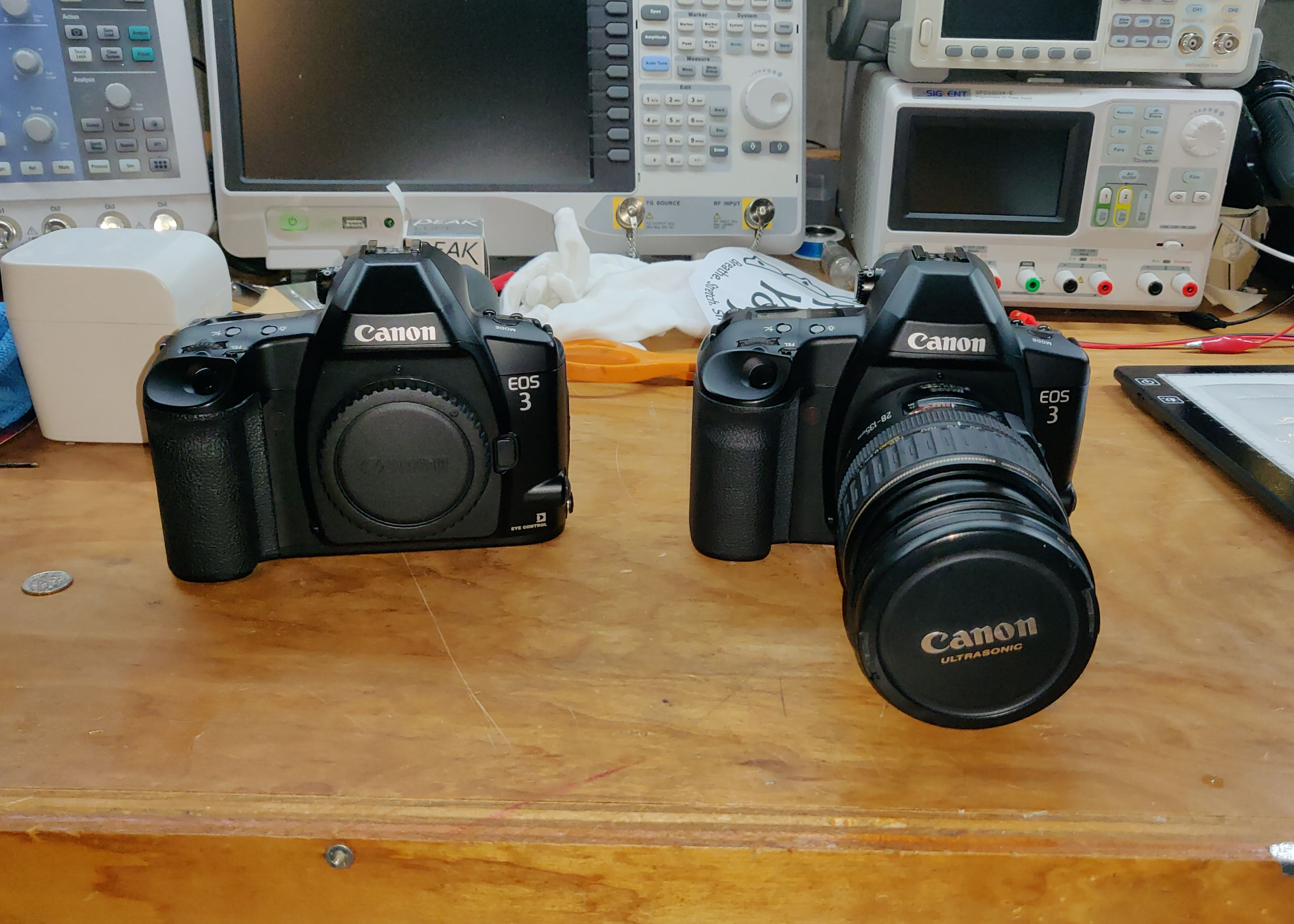

My new EOS-3 showed up. Was advertised as unused and it seems it really is unused. Looking at the date code, it's about 5 years newer than my original.
First thing I did was compare the exposure meter to a couple other cameras and it seemed good. Oddly my first EOS-3 compared relatively close, but then when I initially was trying to sort it out, it was inconsistent.
Now I will shoot a test roll and see how the new camera works.

new camera has the lens
