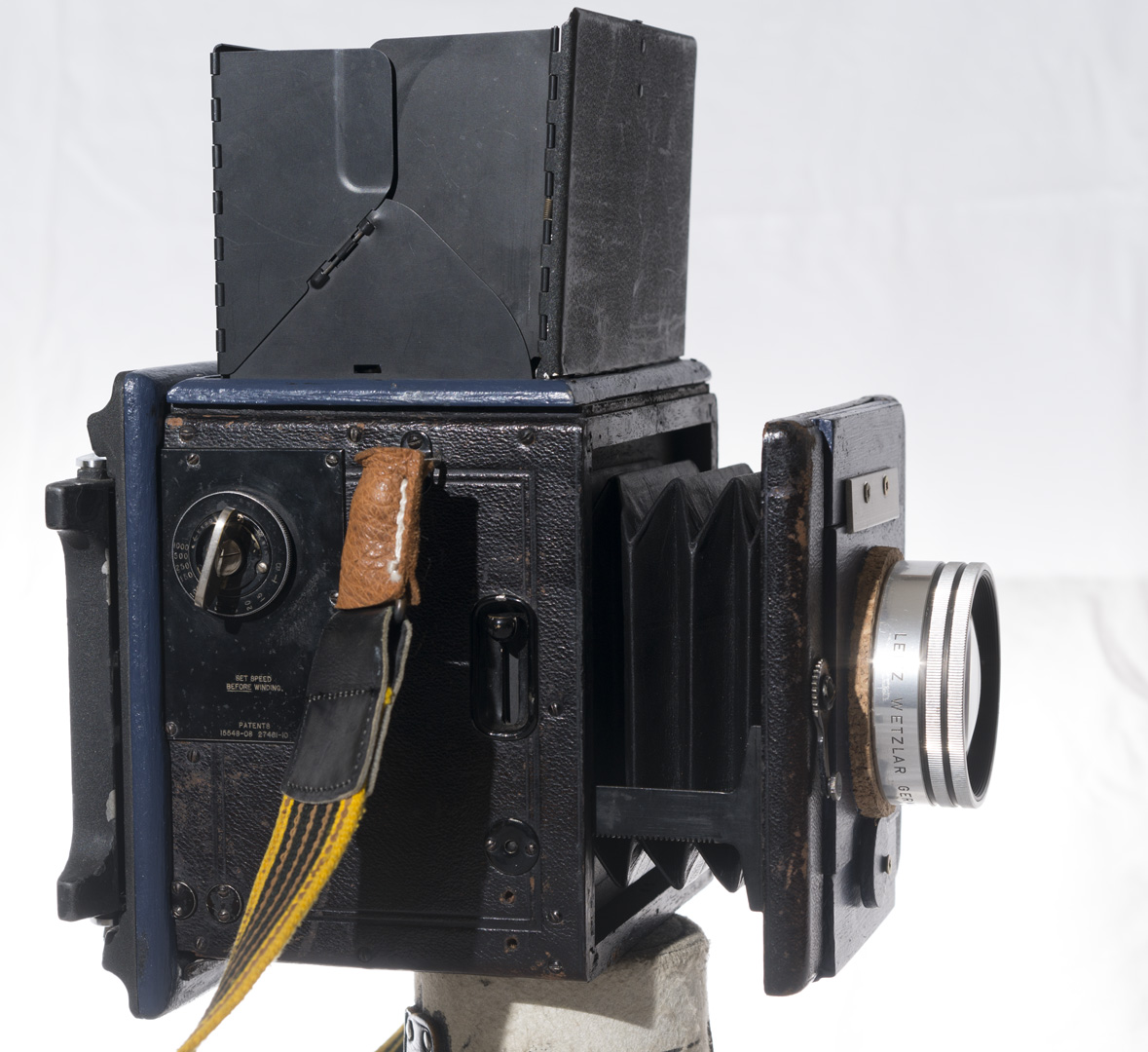

I just got a 3x4 Houghton & Butcher Manufacturing Co Reflex (1915 - 1926) by accident (low bid but got it anyway, and an Ensign Roll film reflex as a bonus). It will need new curtains as they are shredded...
I'm still working on a 3x4 TP reflex (need to find the right ribbons) and on a (Graflex) rollfilm adapter for a 2x3 reflex TP.
I'd love to get some more repair inf
o about these cameras as trial and error is a long process...
Thanks and have a nice day,
Karim
Houghton 3x4 (upgraded to 4x5 Graflok)
Butcher 3x4 (upgraded to 4x5)
Mario Soho 3x4 (upgraded to 4x5)

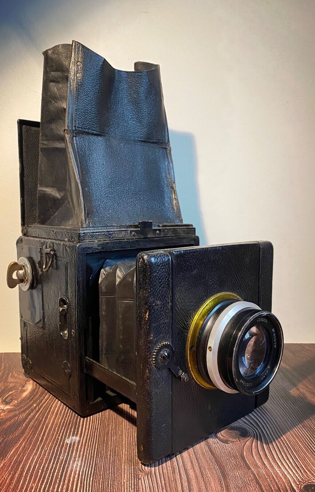

I’m working on a 3x4 pressman shutter replacement. Any advice on the tension spring adjustment?
Ian Grant
Aug 2, 2004
23,414
West Midland
Do you mean the British Quarter plate 4¼"x3¼" Butcher Pressman, also sold as the Ica "Tudor" Reflex Camera in Germany. The shutter is a single curtain with 3 slits, similar to a Pacemaker Speed Graphic.
I have 3 of these two working a Popular Pressman & an Ica "Tudor", the second Pressman needs repairing. Generally I tension shutters until they are running smoothly at their slowet speeds, and then one half turn more.

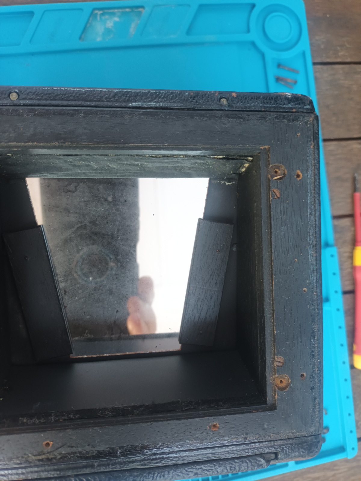

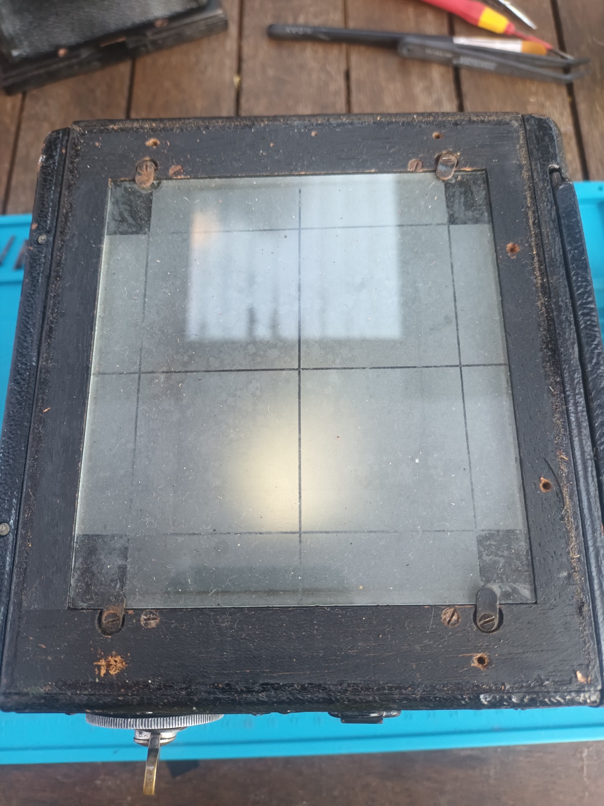

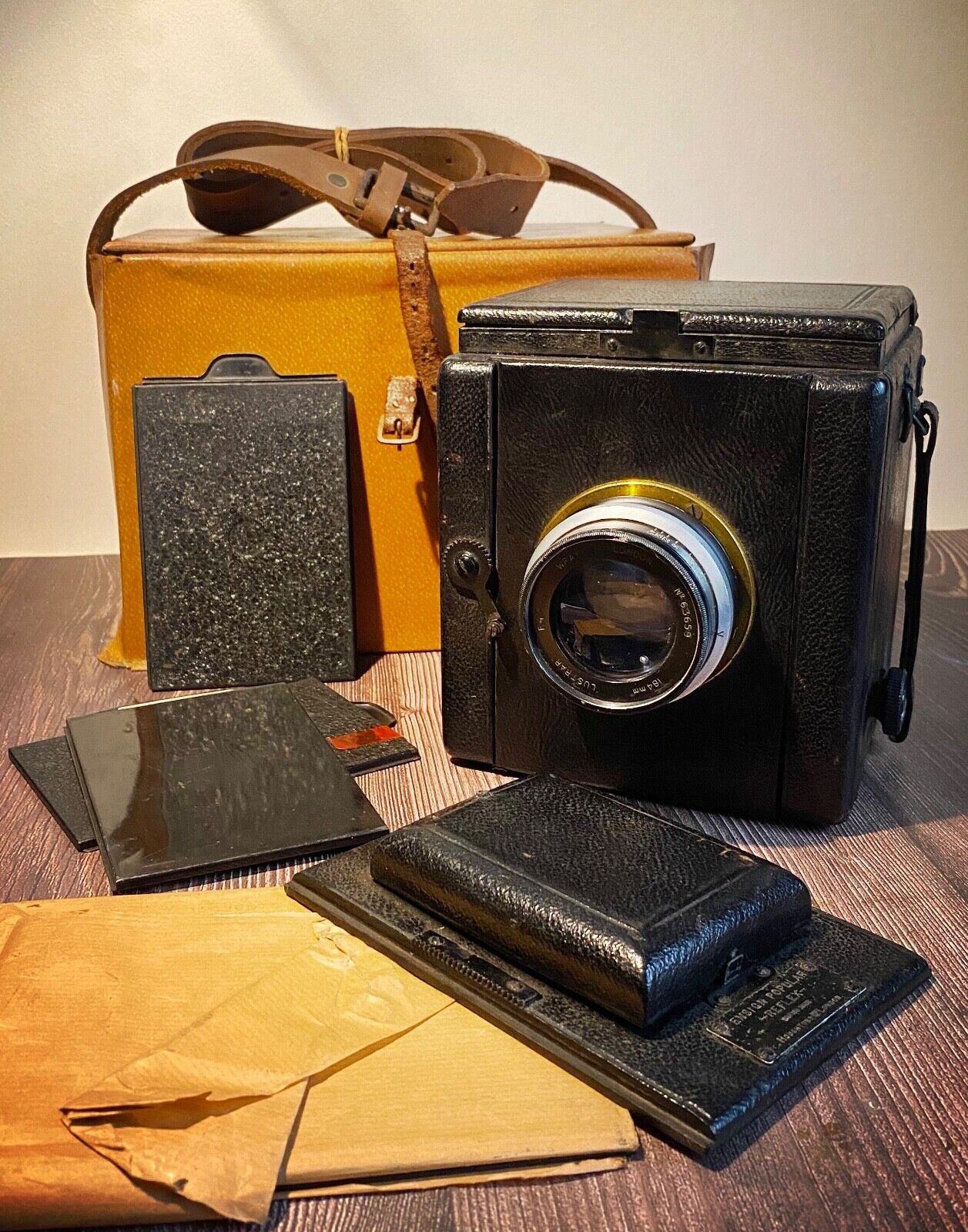

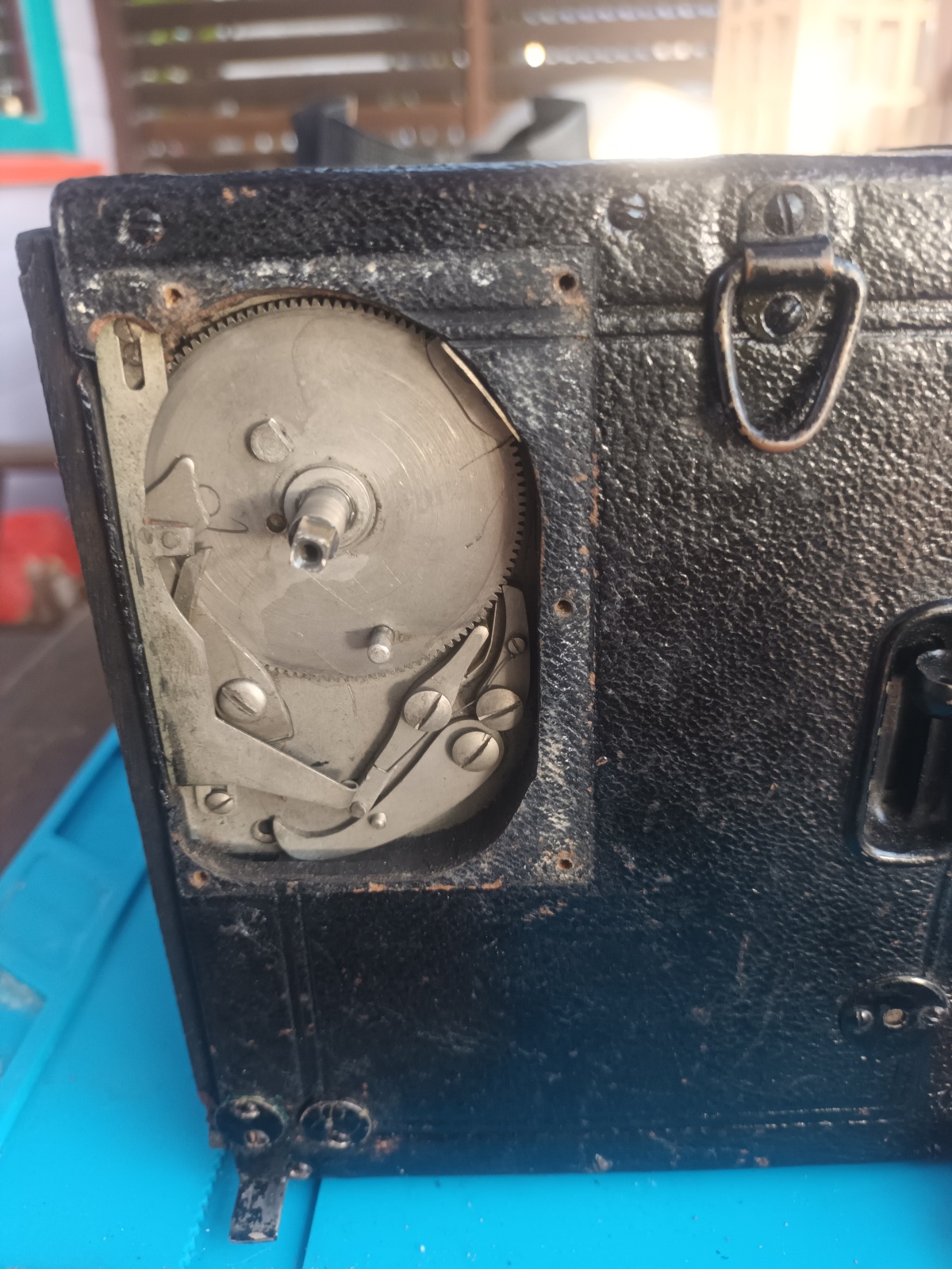

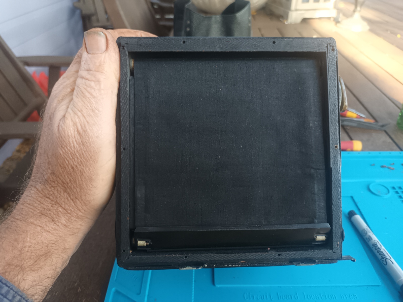

I picked up one this week, managed to free up the curtains and ribbons with the help of some graphite powder. Lubed the gears and it all seems to work again except bulb is like timer, not sure how to fix. Probably not a big problem for me.
Have two different sized lens boards and a copy lens. The only lens I can find that fits is a brass magic lantern lens, so will have to make an adaptor or buy the correct lens.
Doesn't seem to have any light leaks, ground glass and mirror a in poor condition but still usable.
Have four film holders I can use and will cut some sheet film to fit. Have a 6x9 roll film adapter I could fit as well.
Very simple and well designed camera.
