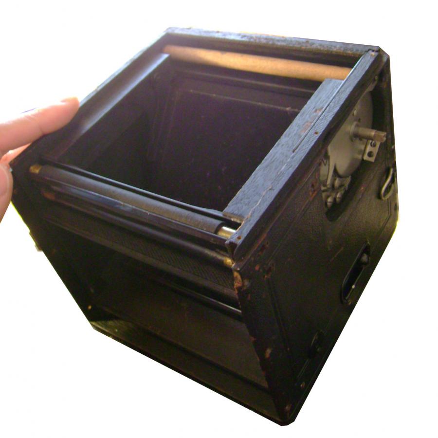

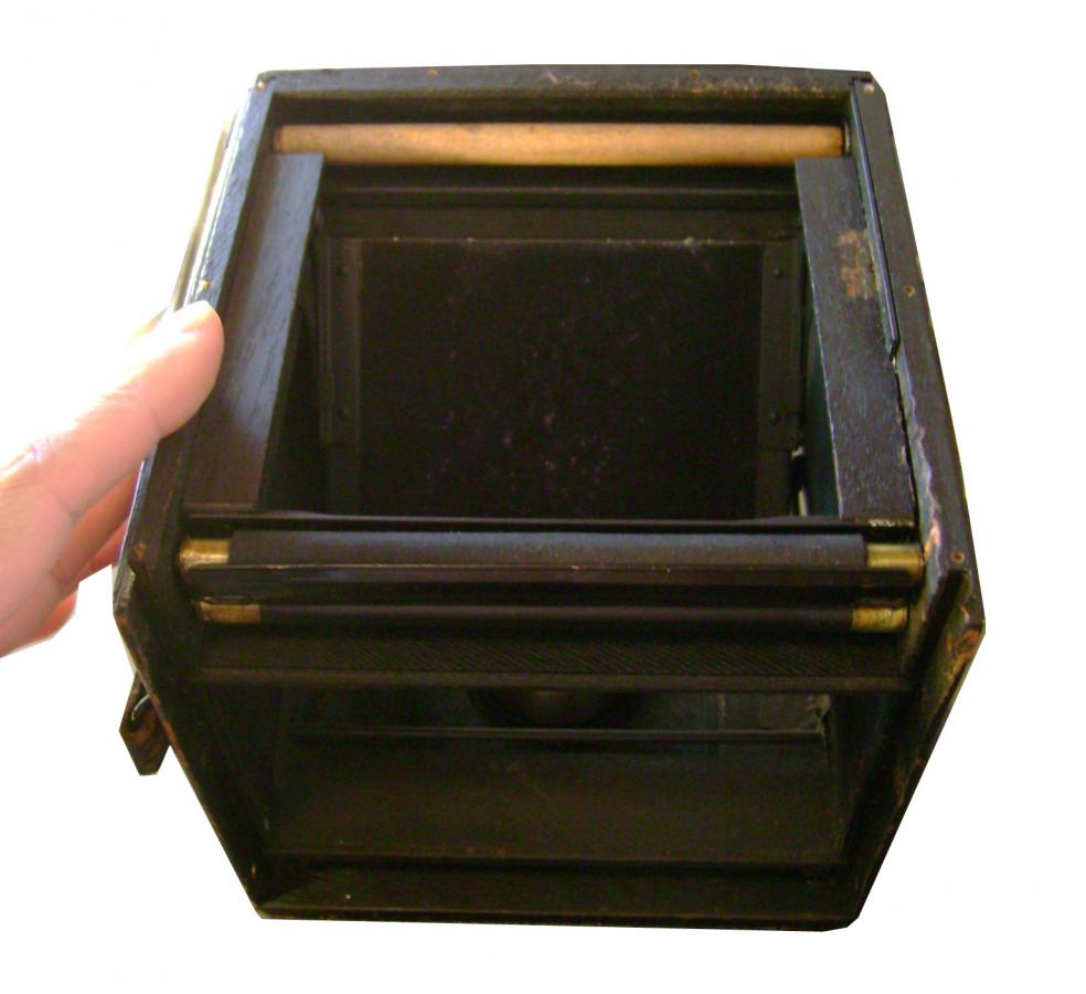

Hello everyone.
A few months ago I bought this fabulous "ENSIGN Popular Reflex" (1920?):confused:
It is in excellent cosmetic shape, but inside it has some problems.
A curtain is missing, but in general appears to have a future.
The rollers have tension if I roll up.
But the problem is I can not deduct how the curtains sewn each other whit the cloth tape, and how long the tape should be…
I'm not a camera repairman, I'm just an amateur with a nice camera that I would like to work ... I had success repairing a “Reflex Korelle”, and I thought, why not with the old ensign. (Should be easier, but in the korelle there was no missing parts)
So any help is welcome, drawings, diagrams, sketches, anything!
Best Regards.
Luciano from Argentina.
PD: I Upload some images to those who wants to help :smile:

Somewhere I've posted a link to repairing shutters like this. My laptop died 2 weeks ago and I'm not straight yet but I have saved not only the links but the pages as well (from a partial PDF - not savable/downloadable).
It's relatively easy to make a new curtain there's patterns in the book, not sure if it covers the Houghton sgutters, it should.
These shutters work in two ways:
1. A single curtain made up of a number of slits, you wind the right bit into position. Graflex's etc
2. A pair of curtains so more complex. Moving seperately like modern cloth SLR shutters.
It could be yours is the first and has just come unglued/sewn. I've rebuilt a Graflex and also a Thrnton Pickard shutter neither was difficult. I'll see what I can find tomorrow, it's late here now :D

Great news, but this one have 2 curtains, the first (the missing one) it´s no missing, i have it, but super dry and cracky, so i have to replace this one, i´ll try to male my own curtain... for this also you can help me =)
But the point is, this camera has 2 curtains. =(

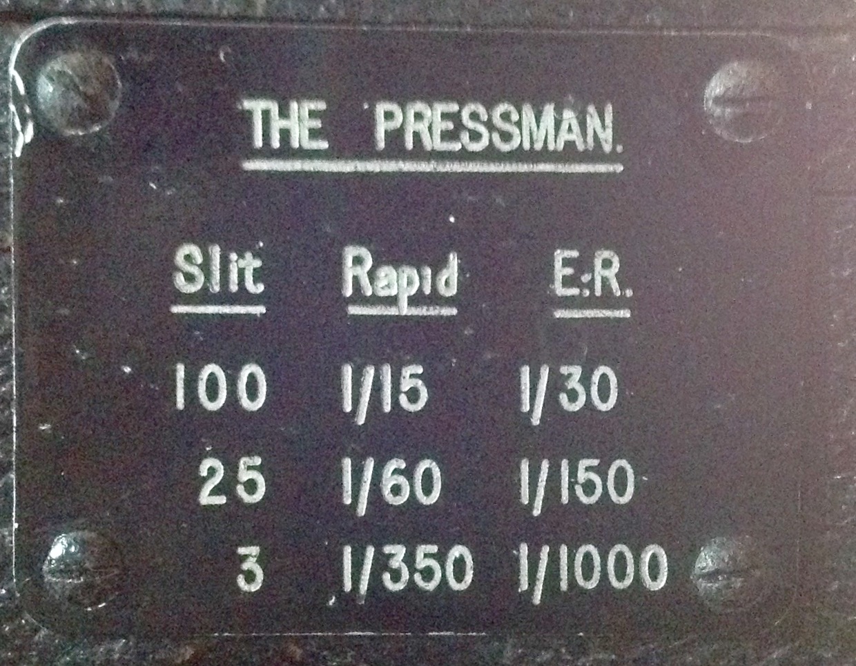

Managed to get an hour to have a good look at the Pressman today.
Disassembly will have to wait a day or two yet.
It's a single long curtain design with a reflex mirror acting as the cap.
When in a fully unwound state the first section is solid curtain and measures 4.5" square.
I say 4.5" because it's a circa 1920's British camera so Imperial makes sense.
However some investigation leads me to believe
that it may actually be a rebadged German ICA model.
The second stage of the curtain is a 4" (100mm) cut out
Stage 3 is all like stage 1 all curtain.
Stage 4 has a central 1" (25mm) cut out
Stage 5 is the same as 1&3 solid curtain
Stage 6 has a central 1/8" (3mm)
Total length I would guess is about 24" plus possibly another 1" or 2" on the rollers.
Upon reflection I think those slit measurements, which are rough, are actually metric.
I say this because the shutter speed selector has 6 speeds which are based on the slit size.
These are referred to as 100, 25 and 3 which sounds, from my quick measurements like metric sizes.
I managed to get a set of digital calipers on a section of curtain and it gave a reading of 0.2mm thickness.
Does that all sound familiar? I will have a sift around the Graflex sites to research their shutters before I take
mine apart. Just want to be sure I can get it back together again!
Does this sound like your curtain material would be a suitable replacement?
Many thanks
Owen
