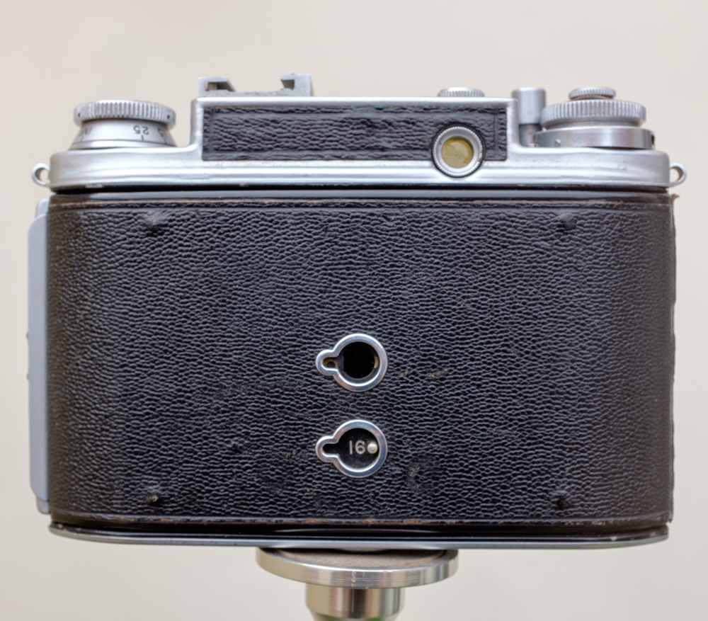

Also, by mine it's the lower window marked with "16" and the upper marked with "12". It seems right though with the film backing?
It is not autowind. it is simply works as a stop when winding on the film after exposure, you still have to turn the winder, perhaps the better word would be auto stop, you wind the film on as normal, but with the 66 the winder stops at the next frame, as per something like the Rollei, but it only works with 66, with 645 you have no choice but to wind using the red window, there is a sort of connection which should prevent the small lever going back , a lock of sorts, and with mine the lever only returns when you try and turn the winder the wrong way, if you turn the winder clockwise then the lever re sets, turn it normally anti clockwise with the lever locked then the lever should stay in place, it clicks into place on mine,as far as the noise, there should be no noise from anywhere when winding, and you should only hear the click of the shutter on the fsster speeds, or the whir on the slower speeds, anything else and the problem is with the camera, I suggest you forget about using the autostop and simply use the red window, yoiu have to anyway for 645, and for 66 using the autostop you lose a frame, 11 instead of 12,

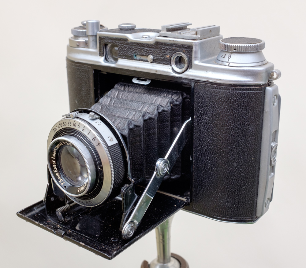

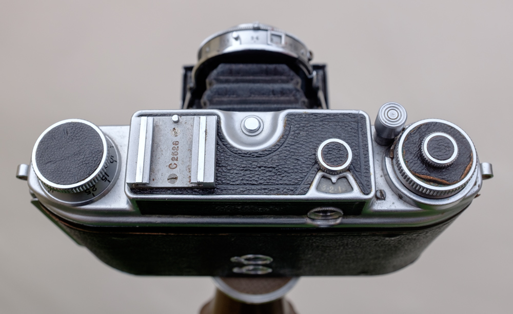

Here are some pics of mine:
The fist version was intended for the War Department / military use, I'd call yours Civilian version 1, to simplify things. I've also noticed each page calling them differently..
I fixed my lever by the way, Richard. I loosened the the three screws around the winder, moved that "cover" around a bit and re tightened them at the same spot. The lever now locks into place but I get the clockwork winding noise when winding. I'm assuming it's a bit like a bicycle hub.
I also think can tell you how you can stop it from locking without the lever, Fraxinus, but I'm not sure there's a revertable way of doing this.

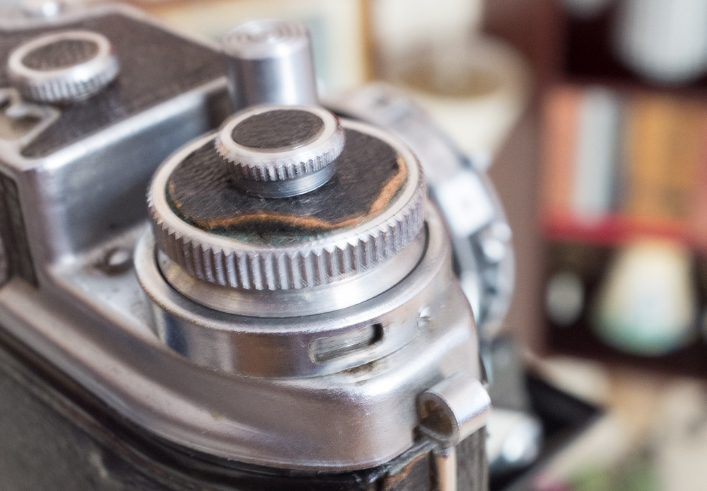

Last year my Commando broke down, at least that's how it felt, after it working decently for 5 years. I now got it into my head that I'd like to fix it and take it along on holidays with me (unrealistic now), but I may need some help.
What happened was that my winder, which was subject of this thread years ago, simply broke. I was winding on film and the lower knob started to lift up, exposing the insides of the winder. I put it all together again but it just doesn't stay sitting where it ought to.
If you lift the top knob to take the spool out, the winding knob can very easily be lifted up too and I'm sure that used not to be like that when I received the camera.
Adding to this issue, the double exposure prevention is on all the time, in other words it's impossible to fire the shutter via the shutter button.
Last night I took the winder apart and had a peek inside, gave it a clean et cetera and put it back together, I however did not see any way that the winding knob could have been fixed to stay down on the top plate and not lift up.
I also could not figure out how to remove the little lever on the side that switches between the auto-stop and manual wind. This lever, as far as I can see, must be removed in order to disassemble the whole winder down to the double exposure preventor (I'm assuming this is under the top plate).
