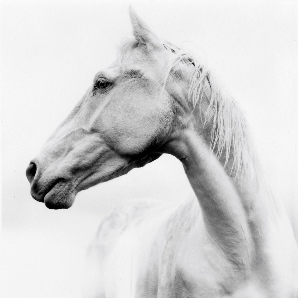

This was done with just Dodging.
Dodging is a really good tool.
That's a great photo. I really like it (and I'm allergic to horses)).
All tools are good if they get you what you want.
