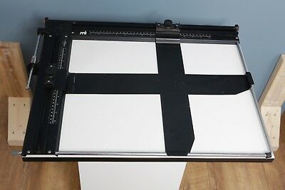

I'm using a Durst M707 colour enlarger, an RR Beard 16x12" easel and usually print on 16x12" paper. All fairly standard equipment and materials. When I insert a strip of negatives from my Mamiya 6 or Pentax 67, everything's fine: I stand in front of the enlarger, work on the image, print 16x12" images (less a tiny margin) and everything's fine with the world. However, when I insert a strip of negatives from my Hasselblad, the image is rotated 90 degrees to the baseboard which makes composition and cropping very awkward. Luckily my enlarger sits on the corner of the bench, so I can move around the left side and at least see the image the right way up. It's not a very comfortable position, as the enlarger column is close to my left arm, which makes things awkward when moving around, but it's workable. Then I run into the main problem: I can no longer make 16x12" landscape prints. When I turn my easel 90 degrees, the left edge hits the enlarger column so the projected image isn't centred on the easel. The best I can do is print around 11x11" square, or around 11x8" if I want to keep the same aspect ratio of the prints.

Just had a measure, and I'd need an easel where the distance between the left edge and the paper is no more than 1.5". (it's over 3.5" on my RR Beard easel).
Any recommendations?

That wouldn’t solve the problem. I would need an easel with a maximum of 1.5” between the left edge of the easel and the left edge of the paper. As I said above, on my Beard easel this distance is over 3.5”, hence my inability to centre the paper under the lens when it’s turned 90 degrees.

If I understand correctly, there would be no problem at all if you were making borderless prints without an easel. When you try to crop the negs, some of them have the edge of the easel get in the way for 12x16 prints @ the crop you want. That correct?
Instead of looking for an easel that is narrower at the edges, could a longer length enlarging lens fit the required crop onto your existing easel?
That's a good point. What focal length are you using in your enlarger? If your enlarger column is long enough a longer focal length will project the same size image further up the column and push the image out further - assuming the column is on a slant.
The OP's enlarger, plus all Durst enlargers I am familiar with, use vertical columns, not inclined ones.
To meet the OP's needs, either the baseboard has to be separated from the column or the head needs to be mounted to the column with an accessory that moves it farther from the column.

I’m just cutting the negatives into individual images. Inelegant, but solves the problem.

This highlights the issue you are experiencing, and helps explain why it is a problem. I don't know that most people understood why it was a problem - most have either a rotating carrier or an inclined column..
The vertical column prohibits you from turning the easel.
The negative holders prohibit you from turning the negatives if they are in a strip.
The only way to turn the negative in your negative carrier is to cut up the strips into single negatives, which I will agree is not ideal.

Yes, that pretty much sums it up. As others have said, my enlarging equipment doesn’t really work for Rollei and Hasselblad negatives, at least for the paper size and crop I want to use.
