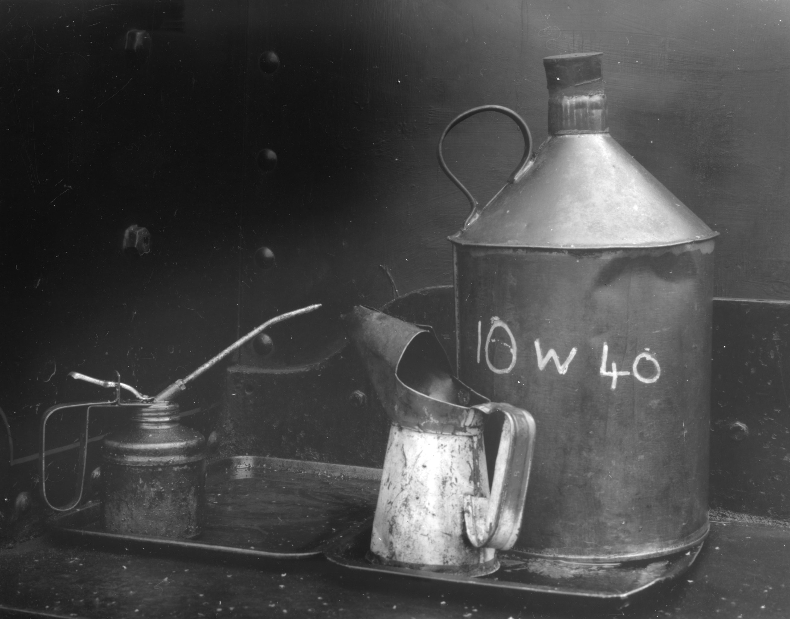

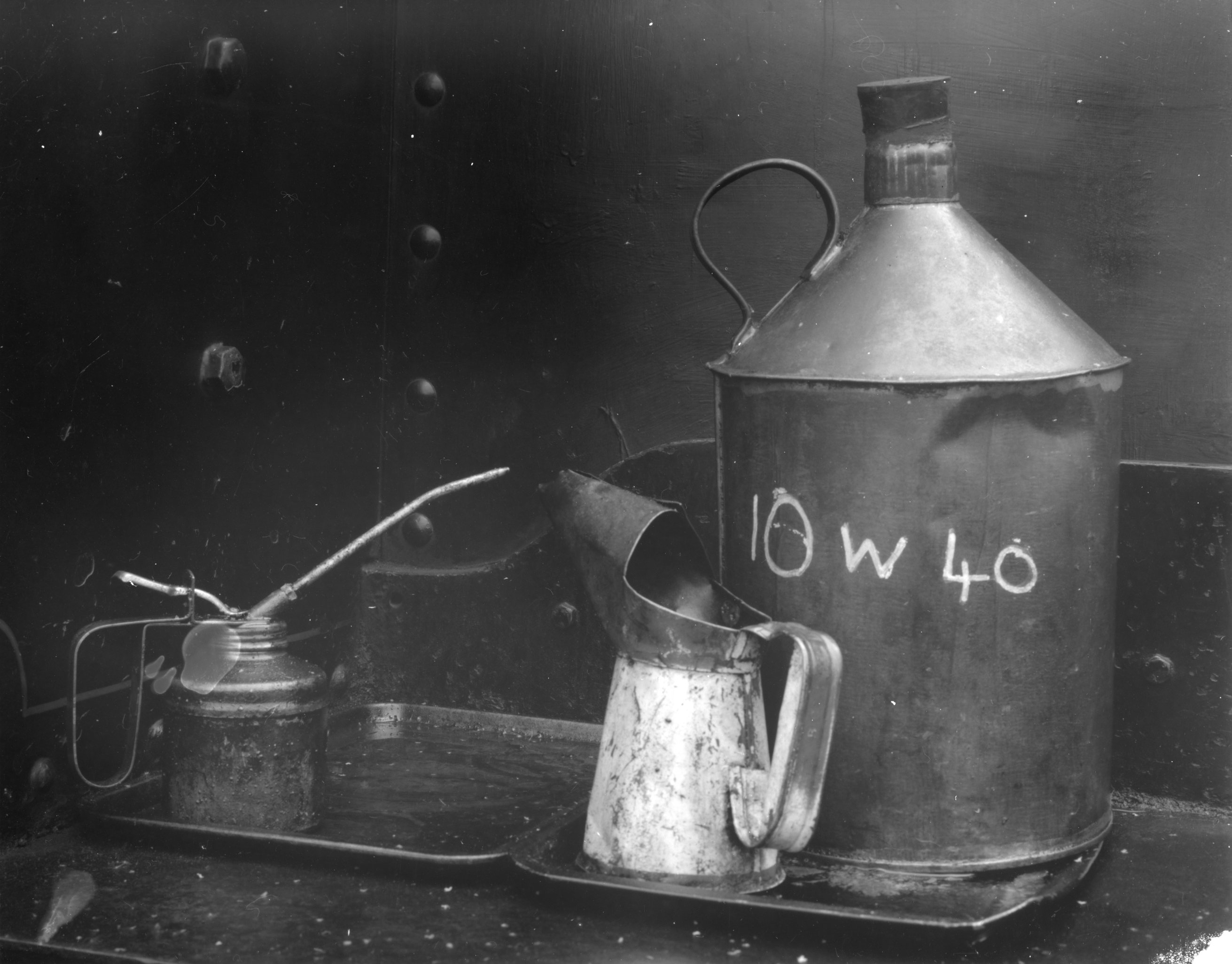

I've done this a couple of times with 4x5 paper negatives. I made the same image on to a 4x5 paper negative, and a 4x5 sheet of Tmax 100, and enlarged both onto 8x10 Ilford MG IV RC paper, to permit a comparison to be made. The first image is from the paper negative, the second image from TMax 100.
I was surprised how similar the two images are. Sure the enlargement times are long, but lith printing has made me comfortable with long exposures

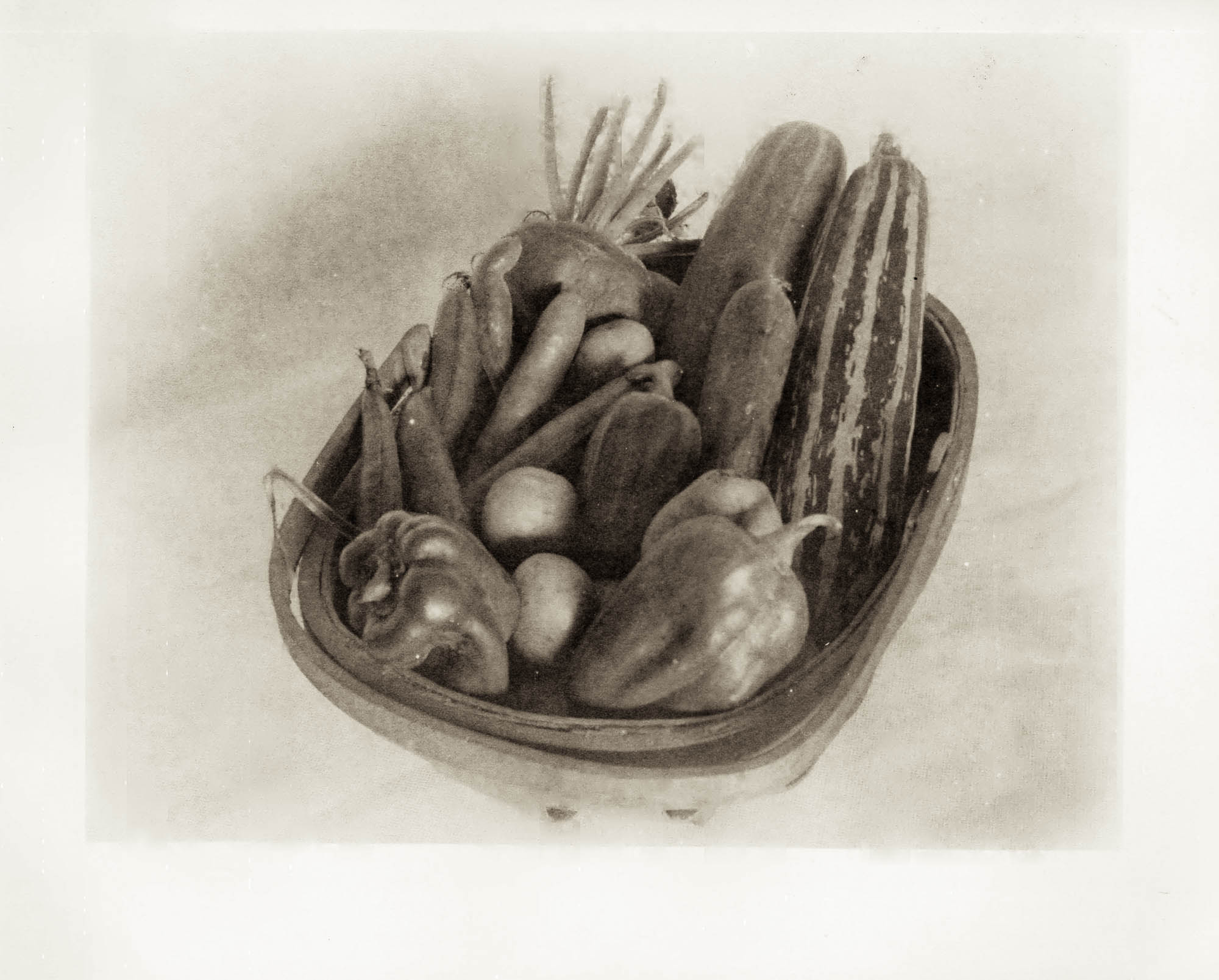

The next example was made using two types of very old paper I was gifted. The negative was made on Kodabrome II RC and the positive onto "Barclays" paper. In this case, the imperfections of the paper show up but I'm happy that they add to the feel of the image, which is framed on the wall above me as I write this.
View attachment 417964View attachment 417965
I was surprised how similar the two images are. Sure the enlargement times are long, but lith printing has made be comfortable with long exposures

Your comparison should convince even the last skeptics that enlarging from paper negatives works very, very well!
I'm also fascinated by the "graininess from the old paper" in your second example.
