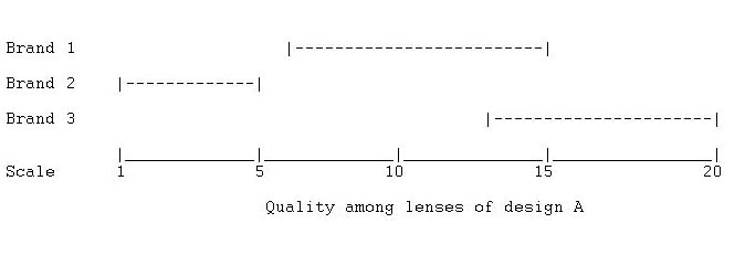

I suspect that individual sample of a given lens design will vary more than differences between competing brands of similar design. .
This is a mathematical impossibility. If the designs were so similar between brands as to be the same, then the variance within that sample of two brands would be the same as the variance of a sample from a single brand. This phrase is just repeating something I have previously challenged on Photrio, which apparently originated with Ctein.
What voceumana said is possible, but perhaps unlikely and difficult to measure. Quality control (lens grinding, centering, etc.) could account for more variation than just the design does, so variation across brands could be wider than variation between them.
Here is a crude graphical representation of this possibility:
From a more practical standpoint, closing down the iris a few stops could make up for a lot of the differences between lenses..

A useful illustration. It highlights that there is no data out there to inform us about variation within one model of lens (manufactures might have made such measurements). Unfortunately, this means that without knowledge of variance within a single/brand model, any comparison between brands is largely useless for lenses of the same design. The only difference I would make to your illustration is to make the ranges gaussian curves as a first approximation.
A look at Ctein's table in Post-Exposure really tells me almost nothing because he provides no analysis of error. Mind, his book is very informative in other ways. It is just that table that everyone refers to that I find somewhat objectionable.

The only difference I would make to your illustration is to make the ranges gaussian curves as a first approximation..
Thanks for the feedback.
Sure, bell curves would be more realistic. But I kept it simple (or as I said, crude). The Y-axis is a nominal variable, "Brand", so it would have been a more complex graph to show frequency distribution, quality, and brand, and I was just using key-board characters to make the graph.
Your graph is great! But our exchange here now covers a bit more complexity.

. . . . .our exchange here now covers a bit more complexity.
Not sure what you mean by "exchange here now", but the original statement that the graph addresses seemed to be restricted to just range or variance ("vary" was used). but I don't want to read too much into it. The actual distribution within each brand is not as relevant as the width or domain of the values, and for most analyses, the central limit theorem makes the sample distributions.unimportant.
But I think your comment about not having enough data, and ctein's table being too simplistic, are very good points. It's easy to lose sight of the basics in photography, and my graph and comments may have contributed to this problem.
I'm sorry that I moved the discussion off track. The 'exchange' I was referring to was our back and forth on a bell curve. Nothing to deep. Again, sorry for the confusion.
I think that Ctein in his book leading up to his lens table does a great job of discussing issues related to lens function and how those issues relate to print making.
