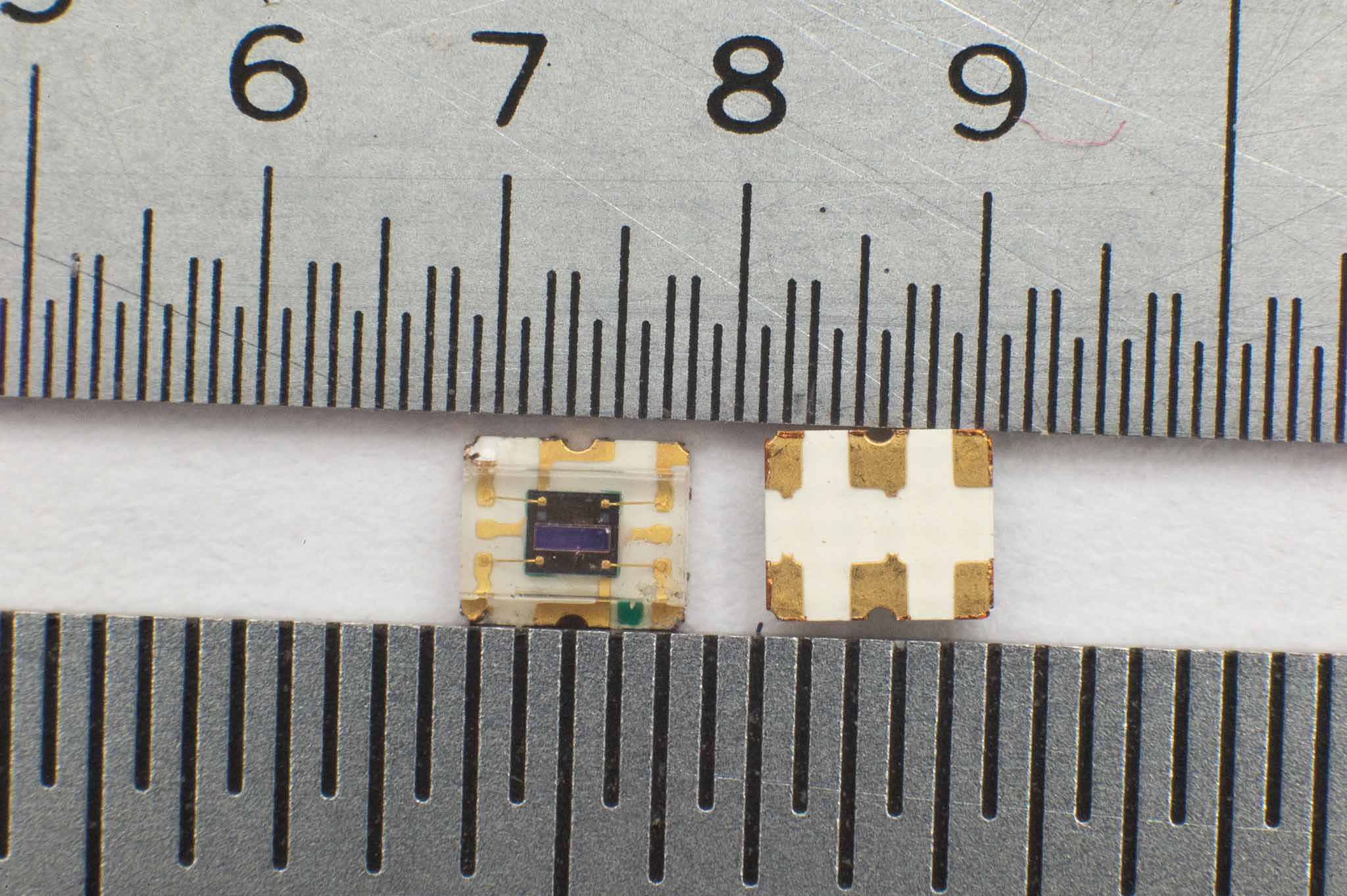

Get a Canon Bellow EF and a 39mm to EF mount adapter. I don't have Canon but I have Nikon and I use the Nikon Bellow with a 39mm to Nikon F mount adapter. I used the setup for 50mm, 80mm, 105mm and 135mm lenses. They all work fine. The picture was taken with the EL Nikkor 50mm f/2.8. Magniication is about 2.5:1. The numbers are 1/10 inch. The division on the bottom scale is 0.5mm per divisison
