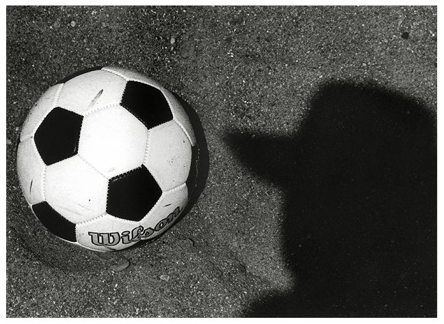

Finally printed some...
So I finally printed some negs taken with the Schneider Componar 105mm... It came out surprisingly well. I think I'll keep using it as a camera lens. I have to learn to use it in a portrait setting first, but it really works!
Nice density in the negs, wonderful sharpness, but most of all I was shocked by the contrast control. Attached below is a scan of a print.
Details:
Lens: Schneider Componar 105mm enlarger lens. On DIY barrel and focusing ring. Mounted to a Pentax KX body with the K-mount.
Film: Fuji Neopan 1600 @ 640, souped in Pyrocat-MC using semistand technique.
Printed: on Ilford MGIV in Ansco 130 diluted 1+1
I'm VERY surprised by the results.
- Thomas

enlaeger lens on 35mm
In your opinion, what are the differences optically between an enlarging lens and a camera lens? Why would one design be used for one purpose over another?
Curious,
- Thomas
An 80mm enlarger lens is designed for medium format, and so when mounted on a 35mm camera will have a much larger image circle than a 35mm lens. It is possible to use a piece of black rubber (e.g. from a bathroom plunger) with a hollowed out body cap to create a flexible mount for such a lens - hence giving you a cheap tilt and shift lens. This is basically the idea behind a lensbaby, but at a fraction of the cost - enlarger lenses are going for peanuts on ebay
jordanstarr
Apr 30, 2007
781
Ontario
there's a photographer in vancouver that uses enlarger lenses to shoot 35mm. i wish i could remember the name or the site address. i was looking at the photos and they were very interesting. they didn't look like that photo of the soccer ball though. the photos were out of focus on the top and bottom edges but tack-sharp in the middle with a little bit of blurriness along the edge of the mid-section. it made for an interesting experiment anyway although i didn't really like the effect, i can see how it would be appealing.
