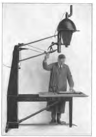

This is a very old pamphlet or book from Kodak, and it talks about things we forgot in this modern age. Like the size of your darkroom being the limiting factor for the size of your prints. Or using natural light in your window to make enlargements. Has some handy illustrations too.
I suggest saving it as a pdf because things have a habit of disappearing on the web. Better yet, print it out.
Don_ih
Jan 24, 2021
8,408
Ontario
Why would you need a large darkroom?

Ansel Adams's first 8X10 enlarger was made from a old view camera and used natural light. I had a friend here in the Phoenix area that made a 4X5 enlarger from a well used Graphic View and a light tube in the north wall of his darkroom that he built out in his garage. On a good day, no clouds, light was even, and fast.

I have an easel "paper holder". Eastman, looks very similar, mine is from the 40's, a work of art. Rochester was the center of all things, like Silicon Valley has been for the last few years
Ironically i once saw a pamphlet that claimed the window enlarger was first created in Englands sunny weather.
But i think that 400 Watt Bulb would be more reliable until the first electric bill came.
Until you set fire to your house, in the 1920s I would not think that the wiring of most houses would have trouble with the amount of current needed to power a 400 watt bulb.

Hey! I have that enlarger!!
It lives in the corner of my garage and only gets used on moonless nights for 5x7 and 8x10 negatives. 😆
God forbid I have to move out of here someday and move it. It is a monster. It took my son and I an entire weekend just to get it set up. But it is heavy duty and solid. I think I could hit that cast iron base with an 8 pound sledge hammer while I was enlarging and not effect the image at all.
And you are not kidding about the wiring. I replaced all of it but I should have saved some of it to show my grandkids what it looked like.
