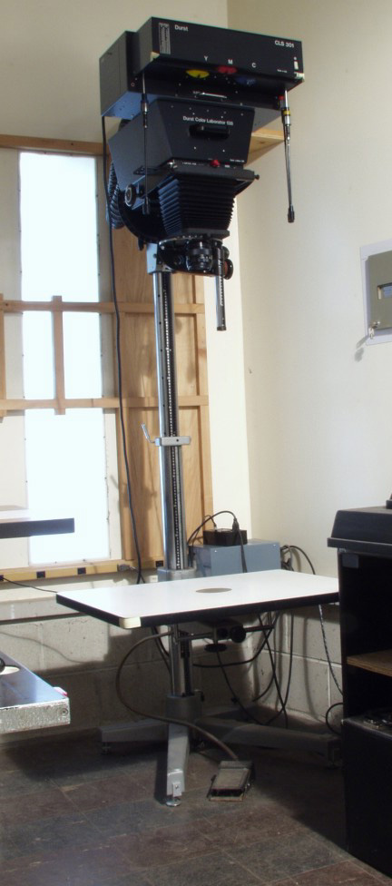

I believe that this is similar to my friends' Durst enlarger:

There certainly are enlargers designed for professional/commercial use - robust machines designed for very heavy use and high throughput.
The Durst line of machines come to mind - not the ones designed for the home user, but the ones like the model that friends of mine own that cost $38,000.00 when purchased new (by a commercial user) back in the 1970s. Working with that enlarger is really impressive, but mostly it just does things really well that other enlargers also do. It is a 5x7 enlarger, so that certainly adds capabilities that smaller enlargers don't have.
With enough room, I'd be very happy to set up a two enlarger bench - one with a condenser and a diffused bulb, the other with a diffusion source. That would give me two useful approaches, although the diffusion source would get used more.
