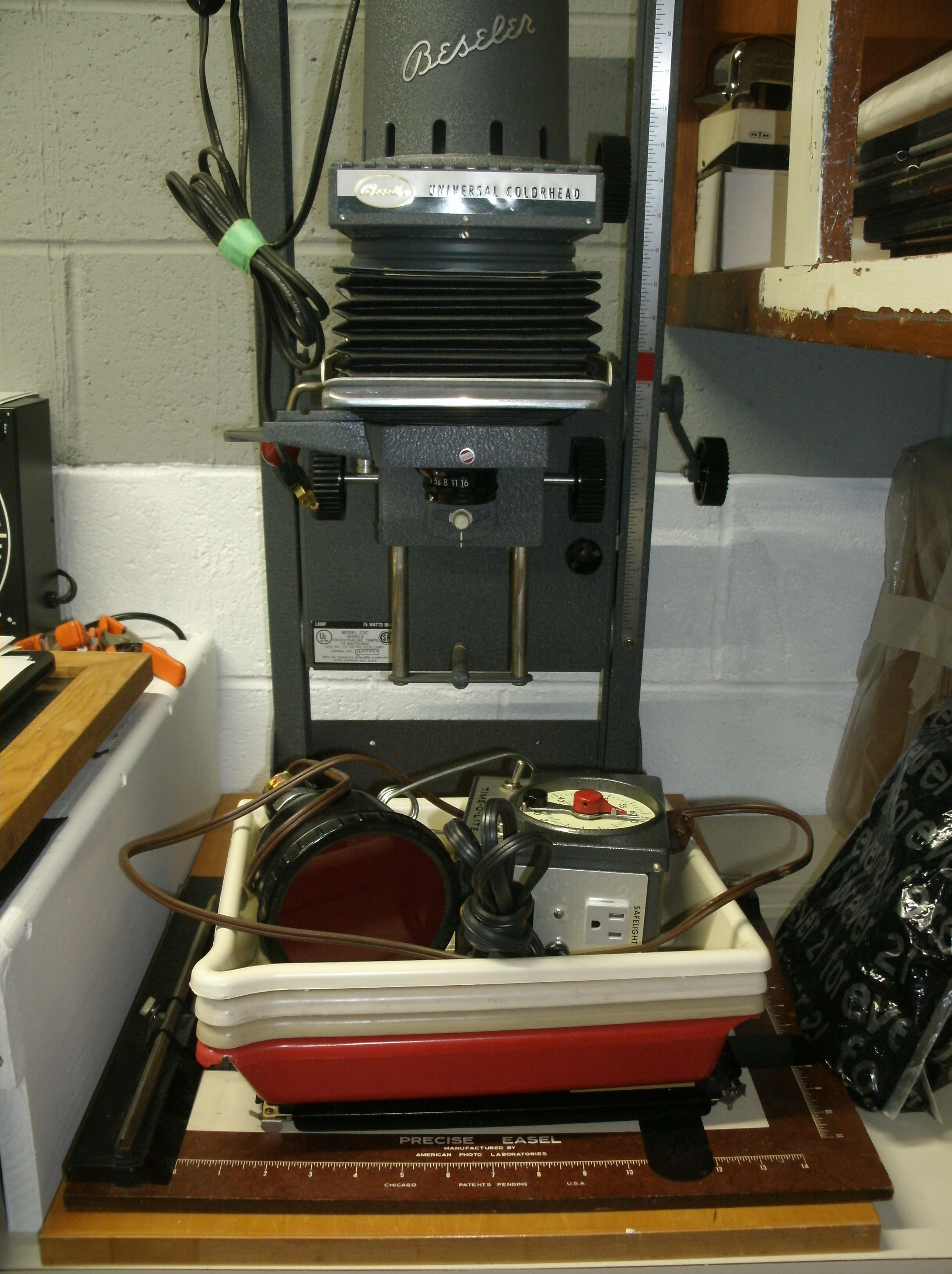

On the first point, here is an older shot of my Beseler 67 with a dichroic light source, set up on its cart in my former bathroom darkroom. Note the relatively massive girder extended column and robust negative stage and other heavy duty features, not found in the current versions.
