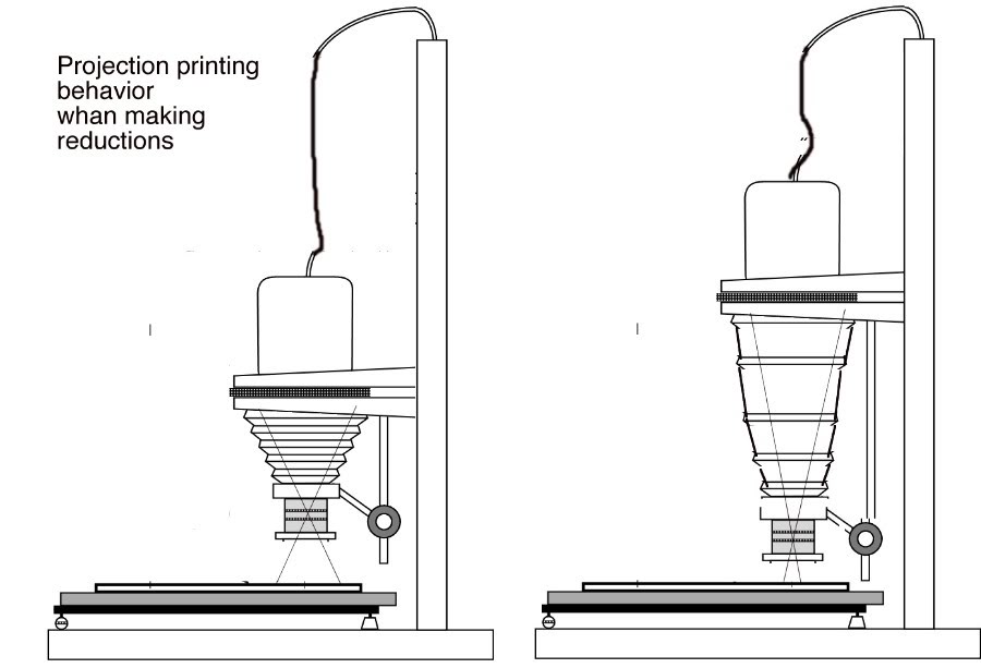

For any enlarger head heigh that is greater than 4x focal length*, there are two focal points. One is for enlargements and one is for reductions.
*All enlarger head heights that are less than 4x focal length will not produce a focused image.
When making reductions, extending the bellows makes the image smaller (after re-focusing).
Key points:
1) Make sure the negative to paper distance is always 4x the focal length
2) Use a lens with a focal length equal to the diagonal of the target reduction size
3) Focus by moving the enlarger head up and down; adjust image size with the bellows.
4) Many small format enlargers don't have enough bellows draw and may need an extended lensboard.
5) Reversing the lens is not needed, the reduction will have increased resolution over the original already.

Key points:
This guarantees very nearly 1:1. No reduction here, contact printing would give the same result.
Why?
Yes.
Yes again.
Huh? Only at 1:1. An asymmetric lens should be used facing normally for enlargements (taking at magnifications < 1:smile:, reversed for reductions (taking at magnifications > 1:1)
