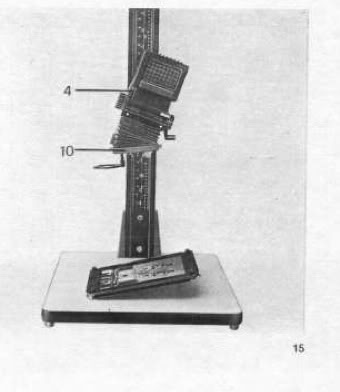

Most Durst enlargers with perspective correction function just like a view camera. I don't even know of a view camera with geared tilt or swing. The big Durst enlargers also have lensboard shift, to keep the image circle centered after the lensboard tit because it does not tilt on the optical axis of the lens.
It is a basic Scheimpflug setup; adjust the tilt angle of the head and baseboard to get parallel lines in the image then tilt the lens to get it in focus side to side.
How are you doing it?
Basically the enlarger needs 2 joints: filmstage (with the complete head) and lensboard.
To avoid the image gettuing off the baseboard either the easel has to be lifted at one side, or a 3rd joint has to be introduced, either by applying a hinge to the easel or to articulate the baseboard as in the 5x7 and 8x10 Durst enlargers.

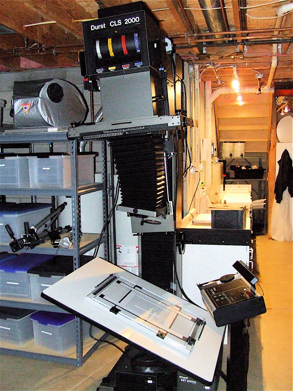

The only enlargers better than the DeVere 504, or any of their other vertical models, is the top of the range Durst units. The DeVere units cannot tilt the baseboard, whereas some of the Durst units are able to do that.
That said, I would take a DeVere unit any day over a Durst. Their simplicity, extreme accuracy of alignment possibilities, among other things make them my enlarger of choice. I have used both a 1000 and 2000 Durst, as in the picture shown by ic-racer, they are fabulous enlargers.
