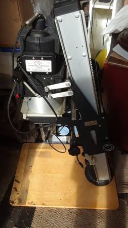

There are a number of enlarger that work with 4X5, Omega D 2, 3, and 5, Beseler 45XL with motor that raises and lower the negative stage, LP, Sanders (sp?) and Durst. You can also find very old and hard to use Federals and Dejours. I have a D3, going on 40 years, rugged, easy to find parts, the D2 is more common. The D3 has auto focus rails that matched to specific lens. Mine did not have the matched lens when I bought it so I took the rails off. D5 have a two bellows system that eliminated the needs for lens cones for longer lens. You can try ebay, Shopgood.com for any listed at a Goodwill store near you. Goodwill usally does not ship 4X5 enlargers Craigs List has a D2 in the Boston area.

The Beseler will not handle 4x5. The best deal out there for this format is the venerable old push up Omega D2. They take some fiddling to get aligned but I have used mine to make prints from 4x5 to 20x24 very happily. You can often find people giving these away because they simply are not worth a bunch.

J, it's a case of what you find on the used market. Yes, to enlarge 4x5....you need a 4x5 enlarger. Between Boston & N.Y. you should be able to find one in good condition, with appropriate negative carrier(s) and lenses. Beseler, LPL, Omega.....they all work.

Thanks everyone! A quick search on Craigslist and marketplace isn’t turning up much; that Omega Paul linked to is about 3 hours away, so a possibility but not easy. I found a Polaroid MP-4 setup on Facebook, nearby, but it’s pricy $750, and I’m not quite sure what it is - a camera setup to enlarge negatives perhaps?
I also have limited space; the 23cii sits in a narrow closet in my bathroom, so I’ll have to make some measurements to see what I can fit in there. Would a 4x5 enlarger generally have a larger base than the 23c?

The Beseler 45MC head turns 90 deg so you can pin the photo paper on the wall for really big enlargements. You could use the 23C base for the 45MC and then just use the 90 deg feature if you need a bigger print.
Not sure the spacing of the 45MC cantilever struts would be the same as rhe 23 baseboard.

You can buy a board at the local HomeDepot or Lowes to fit you space and drill holes to match your enlarger column. Don't make this sound like rocket science.
I cant speak for the 23C, but my LP 7600 and Metopa have the same footprint as my Omega D3. I would be more concerned about ceiling height, my Omega D3 is taller than the LP or any of the other enlargers I have, not sure is an XL column would fit.
I was only pointing out that your suggestion to repurpose a 23C baseboard for a 45MC enlarger likely wouldn't work. Obviously, a home made baseboard is easy enough to make.
Beseler also made a free standing metal table designed to have a 45 series enlarger mounted directly on it. That table was made to allow the surface to be repositioned higher- or lower like a movable shelf so permit huge magnification ratios. Although I do not have that enlarger, I do have that table sitting below my wall/shelf mounted D2 above.
Yeah I’ve got a shelf sitting just over the top of the 23cii, but may be able to remove it if necessary. It’s far from an ideal space, but is the only spot with water and without windows…
If you can pull up the manuals you will find the dimensions including the height. Not sure if the D2 to D5 standard column is taller than the 23C. The D2 and 3 will swivel on the base board to shoot to the floor for enlargements larger than 16X20.
