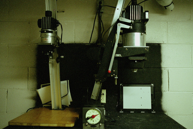

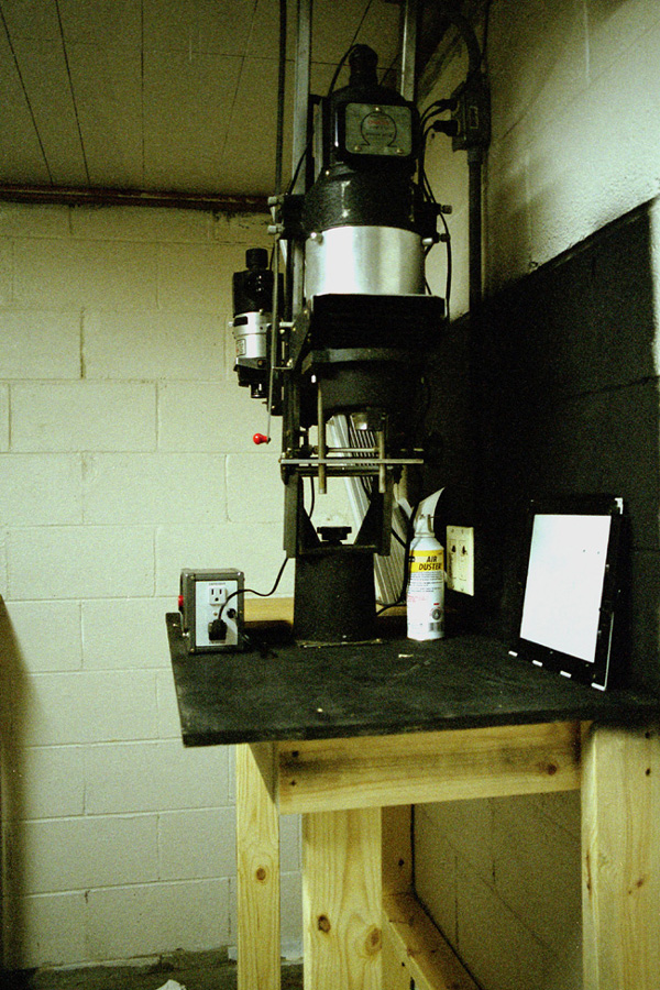

No, My DII is mounted to a plywood top that is fastened to a support, which is attached to both the wall and the floor and was shimmed to be completely level, so if the enlarger is level than it is. One thing I did not do because I never make giant enlargements was mount it in a way that the paper could be placed on the floor, so you may or may not take that into consideration. My b-22 is still on its baseboard since I use it for 35mm, and ocasionally take it off the table to allow for more room for the dII. Cheap easy to build support, all in all probably less then 30 dollars.

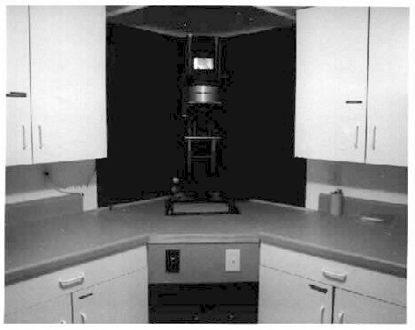

Mounting the enlarger to a counter is very common. Attached is a shot of my (current) darkroom that shows my DII mounted to a corner-counter.
DII's require a lot of head room - in my current darkroom I took care of that by building a recess in the ceiling above the enlarge to allow the head to move all the way to the top of the column.
In my previous darkroom I had to deal with a low ceiling. The solution in that case was to mount the enlarger on a shelf attached to the wall, and then made the counter top below the enlarge adjustable so that I could lower the easle to increase enlargement after raising the head as far as it would go.
Prior to using the DII, I used a Durst F60. That was also mounted on the wall shelf. The only time when it makes sense to have a baseboard that is a distinct part of the enlarger is when the setup must be portable.
