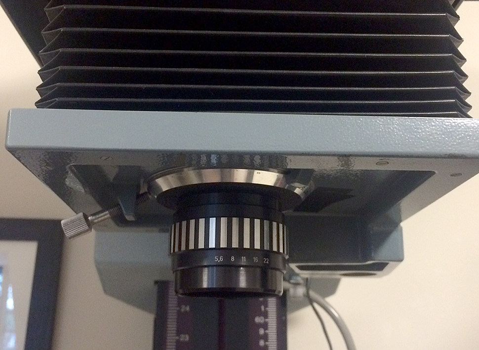

Up to 30x40cm prints there is probably hardly any difference between the lenses mentioned. That is when it is about sharpness.
For me there are other considerations as important: for instance, Meopta made a generation excellent enlarger lenses, the Meogon 50/5.6, the Meogon 60/5.6 and the Meogon 80/5.6. These three lenses have the socalled Zebra barrel, which in fact operates the aperture. In the dark this is incredibly nice to handle, because instead of a smallish aperture ring it feels like we turn the entire lens.
I have all three of them and use them next to Focotars-2 50mm and 100mm. Both these late design Focotars give a lot of contrast. When I have negatives that do not need that, I sometimes switch to the Meogons. It is always difficult to give a name to the result of a certain lens, but I would say these Meogons give me a quieter print than most lenses that are later designs.
Often, the Meogon lenses are sold at great prices. To focus using the relative slow 5.6 aperture works fine for me. I use 150w bulbs. Attached the 80mm Meogon . . .
