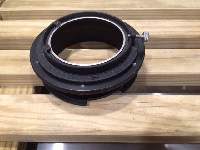

You'll want the flat board with the 50mm hole.

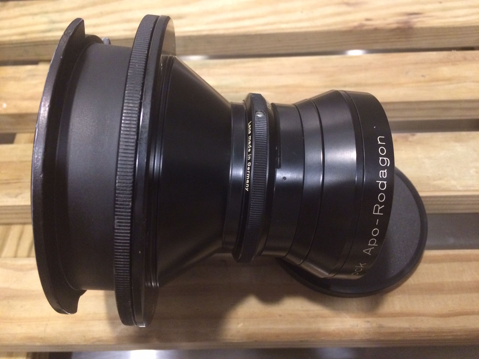

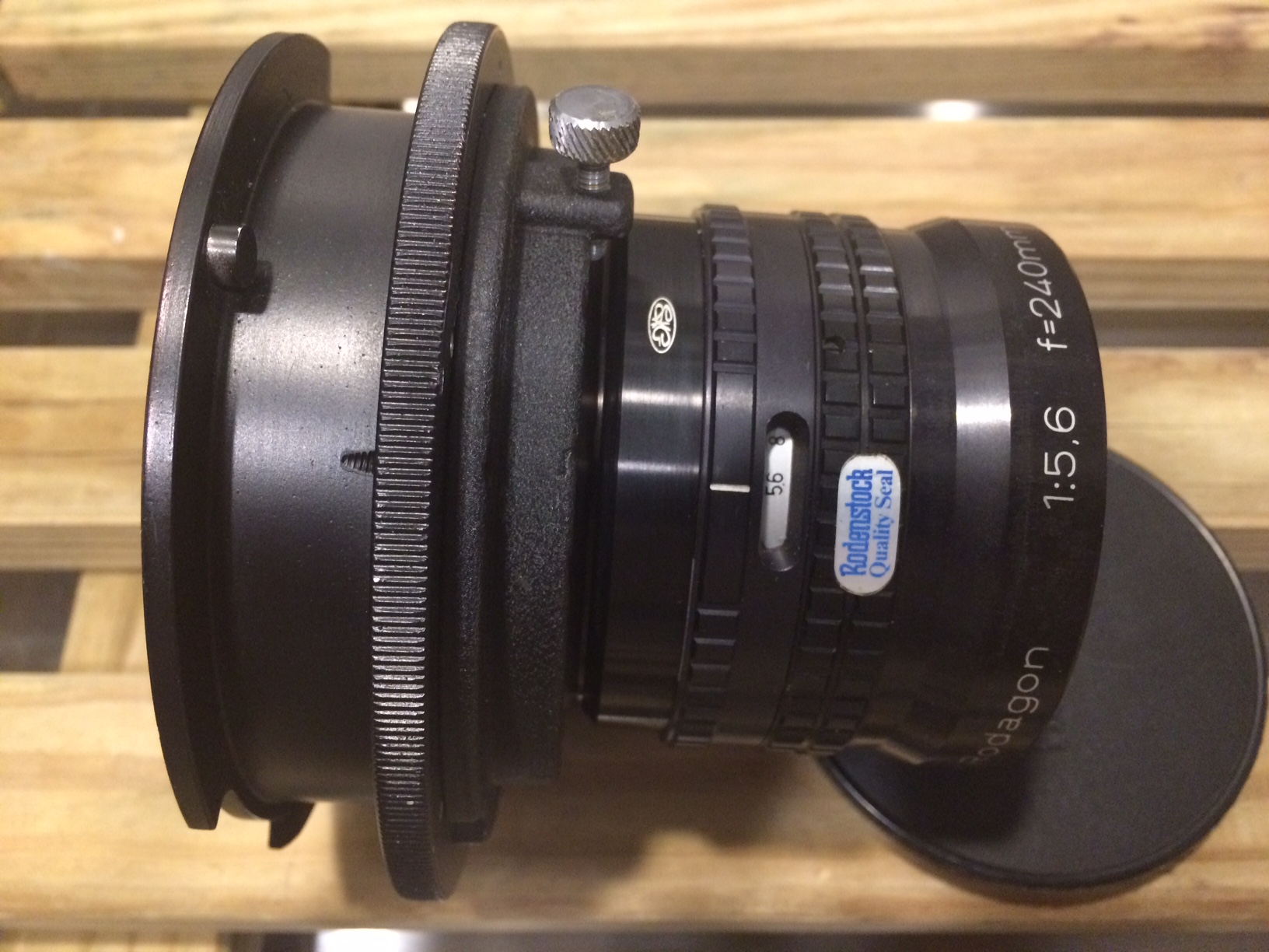

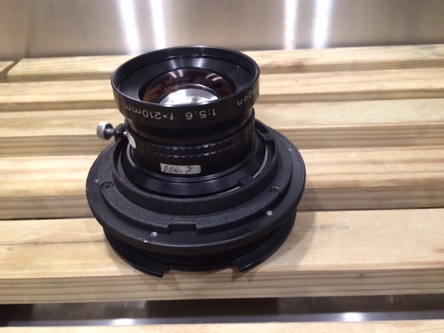

All my larger Rodagon lenses have a lens flange that's 150mm, 210 and 270mm and the flanges are screwed to the De Vere lens boards of my 5108. It's the same with my 240mm and 300mm Componon S lenses.
Ian
I have all my longer lenses (135 thru 240) mounted on Durst Lapla boards and have a single adapter board on an inverted panel for the DeVere. The short lenses are mounted on recessed boards. Larger lenses are mounted on an inverted panel. L

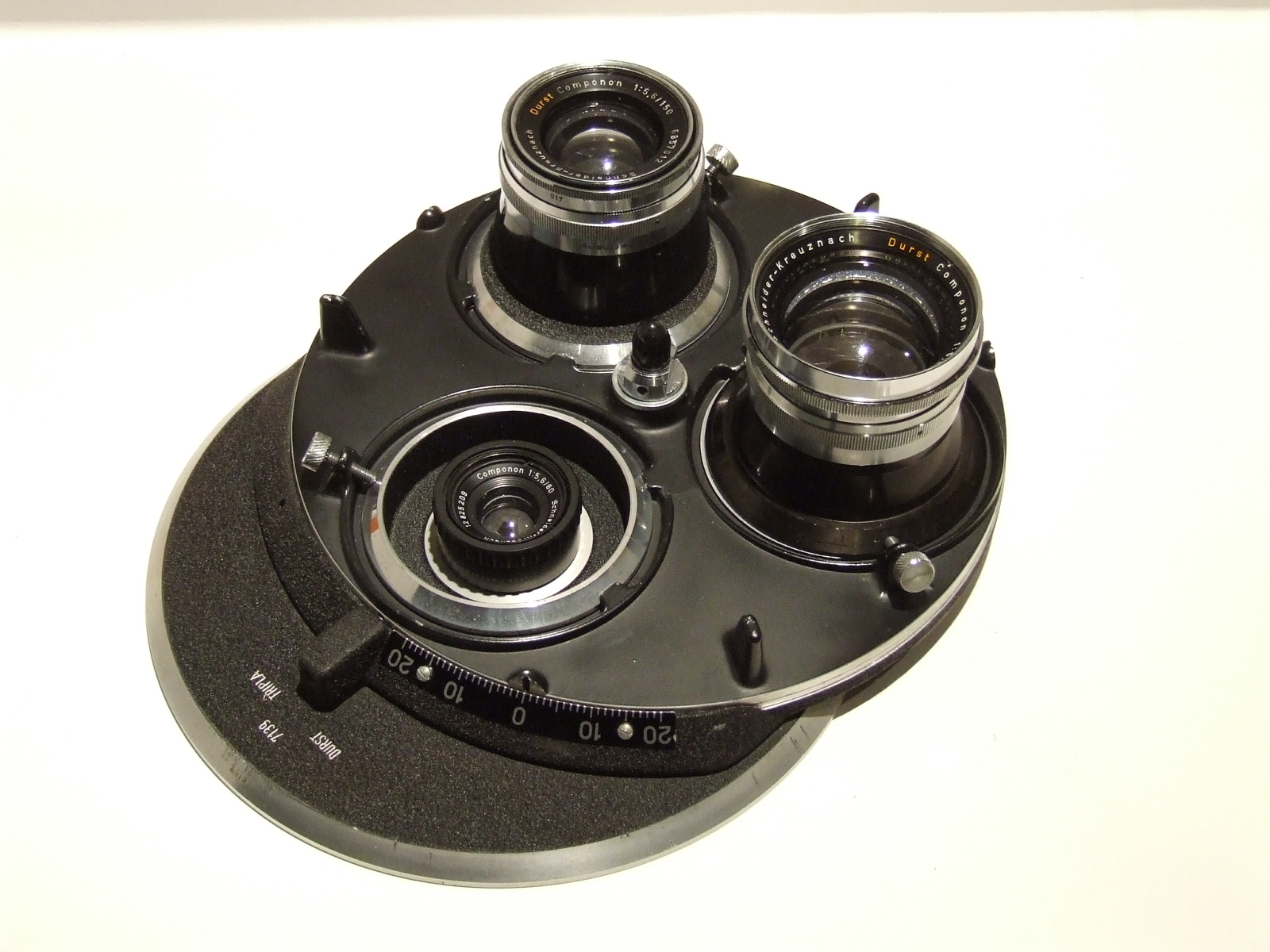

I got this Tripla and the three Componon lenses for almost nothing on e-bay a few years ago. I don't regularly use my 8x10 enlarger for these smaller formats, but I like to have these lenses just in case something comes up. For 5x7 I would use the 210mm.
