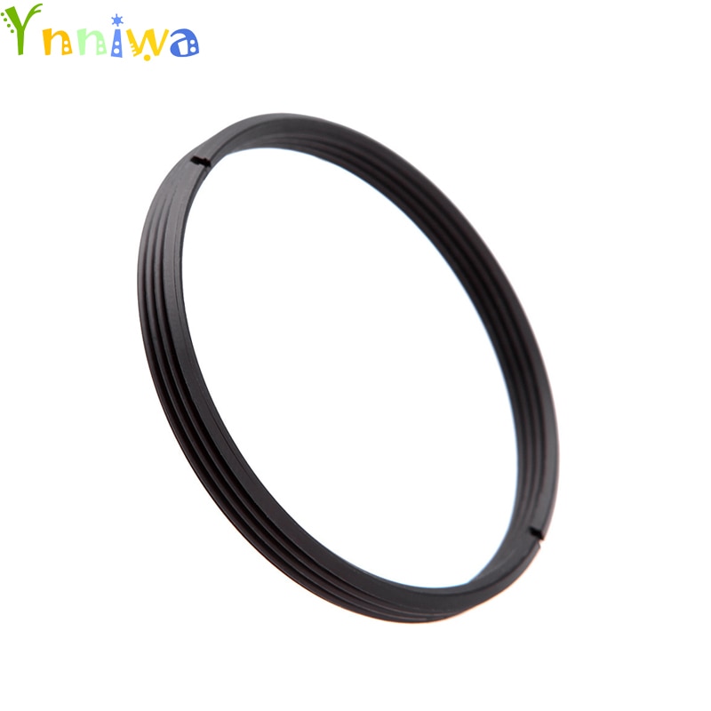

It has a plate with a 69 or 70mm hole that has a screw in adaptor for 42mm. The plate with the 70mm hole is attached with 4 screws, the adaptor from 70 to 42mm can easily be removed by hand. I’d assume that there are replacement adaptors for the Krokus to go from 70mm to whatever. I’ll look around. Or just buy a 42 to 39mm adaptor ring, those are around $9.

Please someone correct me if this is wrong, but can't the Nikon be used in the 42mm board with a retaining ring?
If the threads are long, and you have two oversized retaining rings, perhaps - as long as you added something else to ensure centering.
The 3mm difference is actually quite large.
