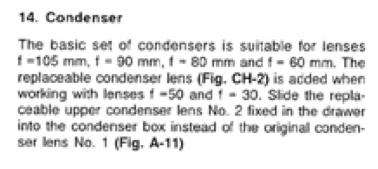

In considering comment #2, I found this rather confusing set of instructions that might make sense if I had any idea what the enlarger condenser set-up looks like:
Pieter12, yes, this could well be the problem. Can you make a better scan of this info?
The manual with that text and the respective photos and legends makes it pefectly clear to me that at the left side of the enlarger condensor-head is a drawer containing condensor lens-element 1 which at shorter focal lengths is to be exchanged by another drawer containing lens element 2.
In certain situations there is even no lens-element used in that position, but either of the two drawers pulled out and the opening closed by a cover, depicted too.
"Additional" lens-element in the legend means being added to the enlarger kit or having to be acquired, not meaning being additional to the existing condensor set-up. There is no lens-element added to the condensor, but at best substituted.
In the original post, he showed the medium format condenser, so he was likely using that.

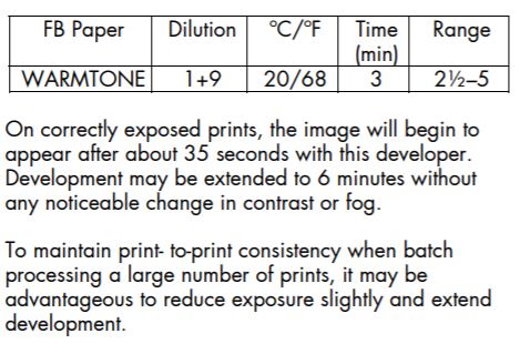

Thanks, what you said is actually quite helpful. Upon reading what you said, something sparked a question in me..how long should I really be developing the print for....? Based on my tests I was only dev tray for 1.5 minutes (*face palm*), when in fact Ilford's recommendation is 2.5-5 minutes dev time (can even go up to 6 mins)...Go figure... You live and you learn aha. I should be able to reduced the exposure time and dev for at least 2.5 mins with decent results. The dev has been exposed to quite a bit of oxygen and hence why the colour has turned more yellow...should probably keep the bottle as air tight as possible.
1.5 minutes development does not seem unreasonable for RC paper, it is what Ilford recommends.
Regarding FB paper 1.5-3 minutes is the recommendation for Ilford Multigrade. The recommendation for Ilford Warm Tone Multigrade is 2.5- 5 minutes.
And warmtone papers tend to be slower, more silver chloride. You are making a 10X enlargement. Should take a while. I use minimum of 2 minutes even with RC. Longer development times usually yield a more consistent repeatable result. I don't go past 3 minutes with my old standby favorite developer, Ilford Bromophen.
