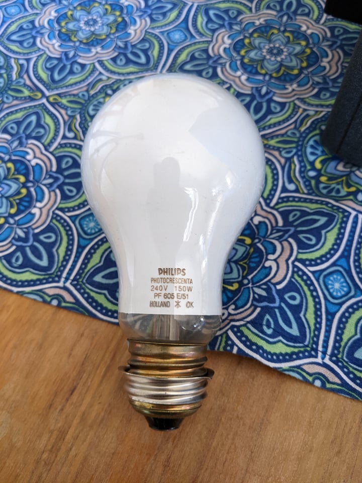

I recently bought a meopta magnifax 4 B&W enlarger. My issue I'm having is that I am getting quite long exposure times (in the 2 minute range). I have printed a range of negatives both thin and dense. I have inspected the bulb to find a Phillips photocrescenta 240V 150W bulb. Nothing about my process in abnormal....I'm using Ilford warm tone dev at 20 degrees celsius. Any ideas? I noticed a small amount of light leaking out of the enlarger during exposure...?

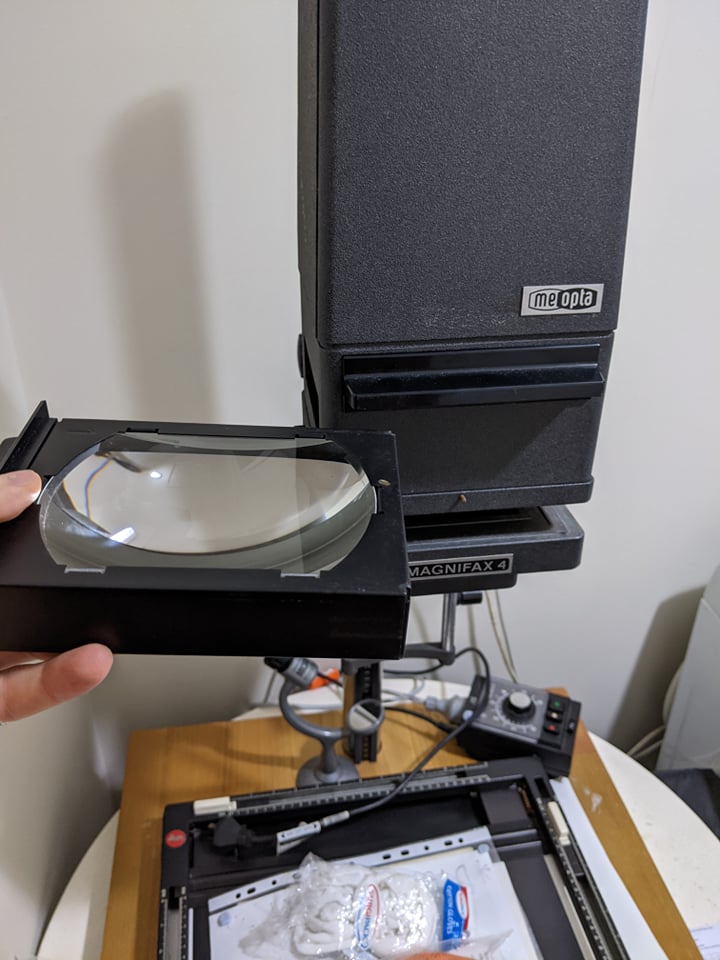

Are you using the right condensor?
There is one for 35mm and one for mf.
Using the mf condensor for 35mm, times may get long.

2 mins with a 150W bulb and negatives that are thin does sound as if something is wrong

Looks like a very nice enlarger. With 150W lamp and a condenser system, with small prints, there is more frequently a complaint on these forums that exposure times are too short.

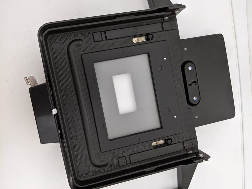

Hello everyone,
I've since made a few more prints so i'll try break it down....
Today I attempted to make a 11x14" print on fiber paper. My exposure time today was about 2 minutes...is this normal? It feels a a bit long? or am I just inpatient? :D
Some more details and settings from today's print from the negative shown in the picture:
Enlarger Meopta Magnifax 4
Lens is a Meopta 50mm f/4.5 stopped down to f/8
Contrast filter is number 2
Paper i'm using is Fomabrom Variant III 111 FB VC Paper (Glossy, 11 x 14")
Dev is Ilford Multigrade Warm Tone at 1+9 (see picture... bottle was opened about 3 months ago could this affect the dev time?) - Dev time is 1.5 minutes

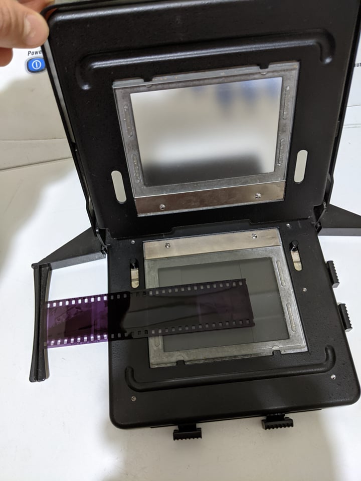

Negative is Kodak P3200 and is quite thin (see picture)
I'm using the condenser on the left for 35mm (see picture)

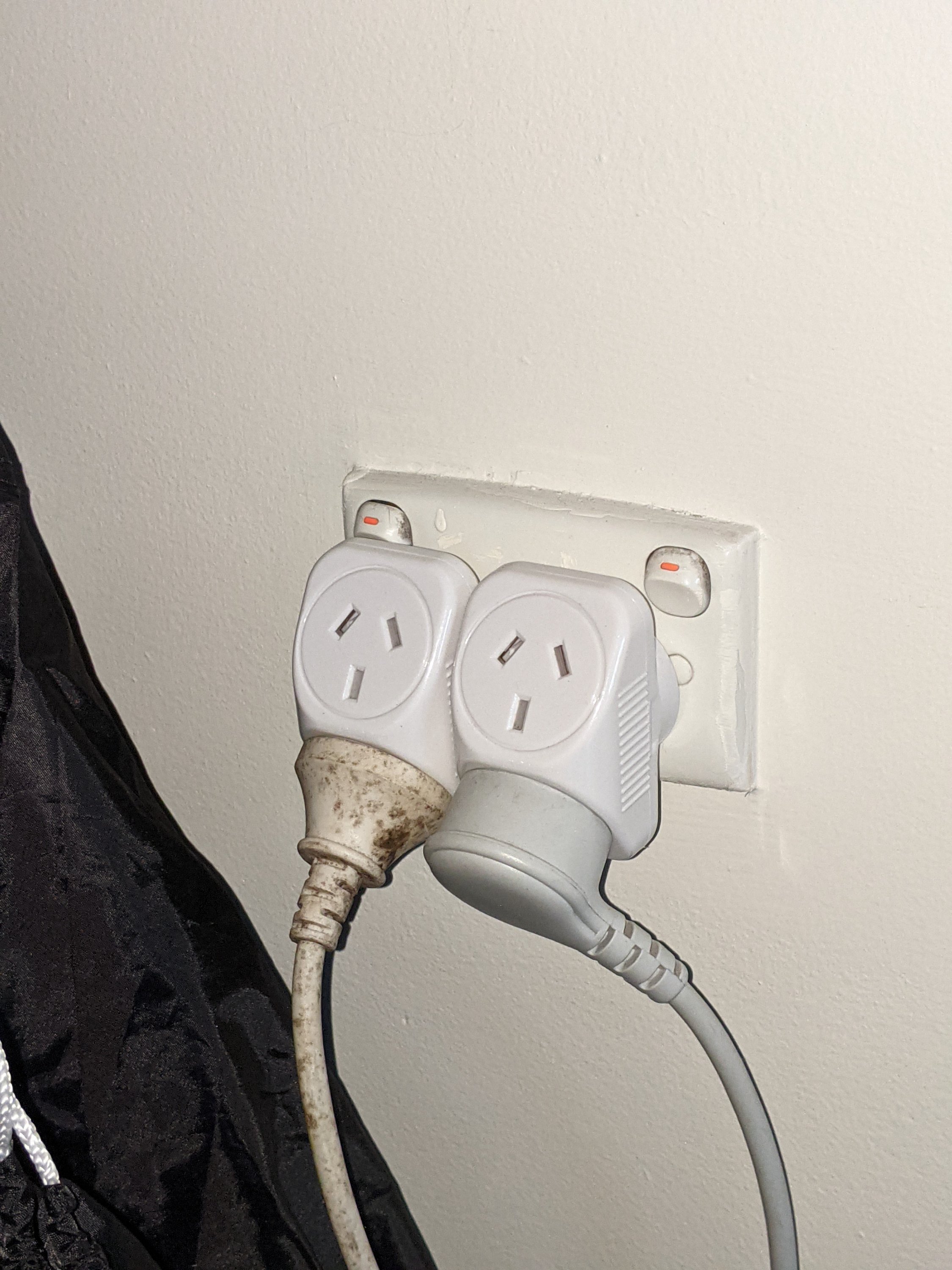

I'm getting power from the wall socket on the left with the socket splitter (see picture)....could this be impacting anything?
I've shared some photos of some of the equipment I am using, the negative I printed from, a test strip (showing 1.75, 2, 2.25 minutes) and other images which may help everyone on here understand more about what I'm experiencing.
Now, in saying all this I printed some tiny 8.9x 12.7cm prints on kentmere VC the other day and had reasonable exposure times of about 15 seconds with very similar settings. The enlarger was approximately only 15 cm from the print where as to print the 11x14" prints the enlarger is a lot further away giving long exposure times which makes sense, however is 2 minutes expected when printing at this size?
There's a lot to unpack here, but i hope it is clear.

Nominal Mains voltage in Australia meanwhile was reduced from 240V to 230V. This has effect on the effective output of that lamp. Both on gross light output as spectral characteristics.

Looks like you're doing everything right. That negative strip is not thin - two minutes for 11x14 at f8 is pretty normal. Open the lens to 5.6 and try a minute - see if there's a real difference in the final print (probably won't be much of one) - that's still not wide open.

Two minutes seems awfully long to me. I usually expose an 11x14 in ~32 seconds (5 stops of time). That's using a Beseler 45, PH212 (150W) bulb, 50mm lens at f8, Ilford MGIV #3 filter. That is 2 stops less than the 120 seconds (7 stops) you are seeing.
I would chalk it up to a combination of factors: the paper is slower; the enlarger puts out less light; pulling the print a bit early in a slow developer - warm tone developers take a long time; a preference for dark/low key images. If each factor contributes a 1/2 stop / 40% increase in time and is not really noticeable on its own, when added together they produce a 2 stop / 400% increase in time, which is decidedly noticeable.

Fomatone is pretty slow so possibly fomabrom is as well, and 35mm to 11x14 is a decent enlargement so it’s not too worrying I would say. Look at the bright side, I tried using fomabrom in lith developer and it took 30 minutes :D
he base fog on the negative does look a bit high - I mostly do 120 so I’m not sure if it really is…

I suspect that the OP is experiencing, 1/d2. The intensity of the light from a source is inversely proportional to the square of the distance. So a 11x14 takes a CRAPLOAD more light than a 4x5. The lens probably isn't really a 4.5, the condensers are probably meh, the paper isn't fast, the developer is warmtone, ie more bromide longer development times, and last but not least the unnecessary #2 filter.
Short answer work up in magnification, get an f2.8 El Nikkor off Ebay. Then the times won't be a surprise. I've seen guys that kept time constant and marked f stops on enlarger column. Need a faster lens for 35mm or just relax. And hope the negative doesn't buckle in the heat :smile:

Suggestion: Check over the condenser if there is no ground glass. If there is one, try to remove it and enlarge without it.
