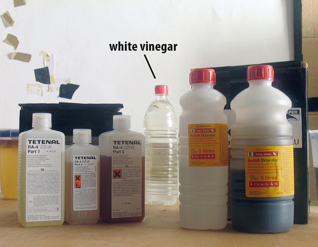

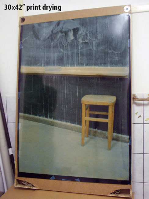

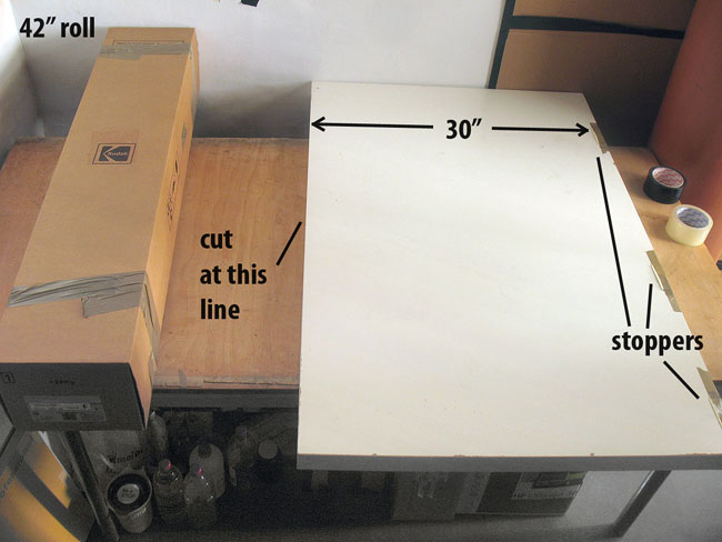

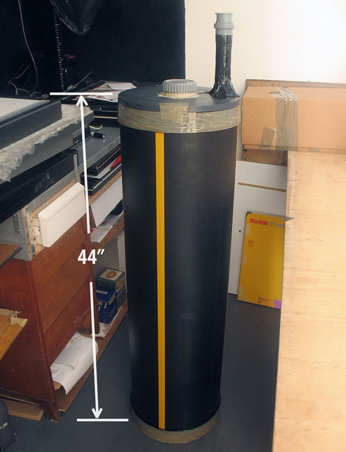

frotog, could you elaborate a bit more on the problems that you had to face when hanging a piece of paper from a wall? The pics below show what I did and, yes, it was done with a Rodagon-G (50mm @f4-5,6) and, yes, the image basically consists of ultra-sharp grain even at the very edges (from a 400 ASA Agfa 35mm colour negative) and, yes, handling the paper and taping it to the wall requires some effort, but...

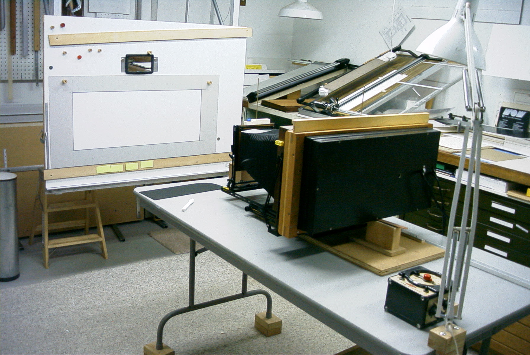

Frotog is correct about the vertical enlarger column problem.
It limits the width of your print size.
I had one of those blunderbuss Durst 138's.
Sold that 150 pound tank and its stack of condensers (one stack for each film format).
Replaced it with a homemade unit from a modified 5x7 monorail camera.
Made the same mistake... a vertical column...
I replaced that with a 4x5 Beseler bolted to the wall.
The counter below it has slide-out shelves at various levels.
While not "mural size", I can enlarge to 32 x 48" easily.
Some visual hints from my darkroom here:
http://www.classicbwphoto.com/classicBWphoto/Darkroom.html
Regarding wall projection and paper handling...
A couple of years ago I wall projected 8x20 negatives using my 8x20 camera.
The easel was a sheet of plywood covered with 26 gauge painted metal.
Buy the painted metal from any sheet metal (HVAC) contractor.
The metal is steel, and magnets really like that stuff...
I made a series of magnetic ledges and magnetic knobs to hold the paper.
I used whiteboard markers to sketch out paper placement on the easel.
Wall projection is not fuss-free, but it can be done.
