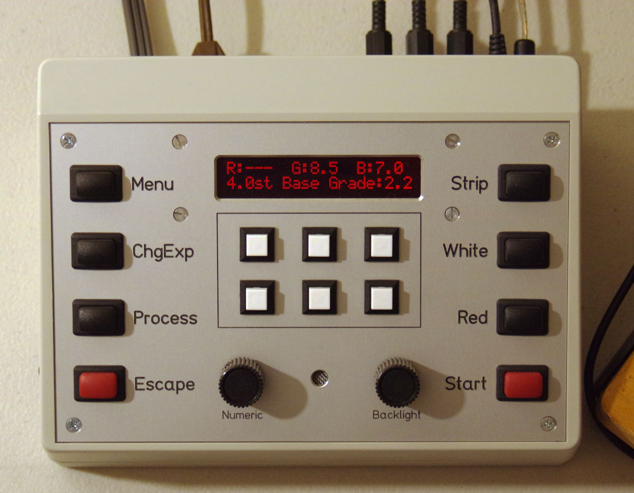

I have designed and built two LED controllers. Here is the second one:
There are six "soft" buttons below the display. The upper row of three buttons correspond to the items in the upper row of the display. Likewise, the lower row of buttons are for the lower row of the display. The two columns of buttons on the left and right sides are "hard" in that each performs a single function. In my first controller, the upper row of buttons was above the display, putting them closer to the display-items they affect, but I found that when pushing them, my hand partially blocked the display. So I put all buttons under the display, which has the second advantage that one can put a grayscale above the display like the RH Designs Analyser Pro. If your controller has fewer functions, you can replace the soft buttons with hard buttons.
My display is character-based. A graphical display would look better, and could display a grayscale so it wouldn't need to be a fixed part of the control panel.
The left knob is marked "Numeric" because it's used to enter numbers. Pressing down on the knob while turning it causes the number to change in larger (5x) steps. The right knob controls the display's brightness, and pressing it turns off both the display and safelight in order to blackout the darkroom for color work.
For a LED-based lamp with separate color-control, one can have a hard button on the controller labeled "Red", as I do in the photo above. It turns on the red LEDs, letting you position a tool before starting a burn or dodge. During exposure, the red LEDs stay on to help maintain position.

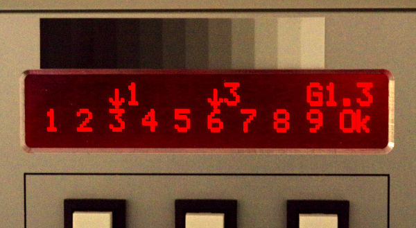

Test strips can do more than tell you exposure time. One test strip can determine both exposure and grade. And if its range is large, it can also determine burn/dodge times. Here's a sample display showing determination of exposure and grade:

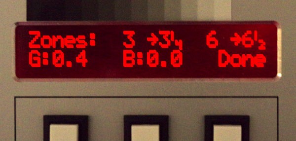

In this display, we are telling the controller, "On step 1 of the test strip, zone 3 is correct, and on step 3, zone 6 is correct." By "zone X is correct", we mean that tone X on the step should print as tone X. The zones are marked by the numeric scale under the arrows, but as shown in this picture, the tones can also be marked using a grayscale. Thus, zone terminology is not needed when using a grayscale.
The positions of the arrows and the step numbers next to them are set using the knob after selecting them with the soft buttons. When changing step numbers, they change in quarter-step increment, 1 to 1-1/4 to 1-1/2 to 1-3/4 to 2 and so on. When increments are large, tones are seldom correct on a step, and this quarter-stepping lets you estimate where the tone would have been correct. "Let's see, this skin tone would be correct a little before step 6, so I'll enter step 5-3/4."
After entering the two steps and their zones (or positions on the grayscale), the controller calculates both exposure and grade. In the above example, the grade is 1.3.
Also, you can enter one step and zone, omitting the second, and the controller will calculate the exposure, leaving grade unchanged.

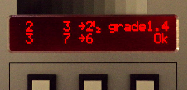

Here is a more general way of specifying steps and tones.
The upper row of the display is telling the controller that "On step 2, elements in zone 3 shall print at zone 2.5." The lower row is saying, "On step 3, elements in zone 7 shall print at zone 6." The controller is telling us that doing so will print at grade 1.4. Instead of zone numbers, the upper row could use arrows or letters (such as "S" and "P") at the correct positions under the grayscale. "S" would stand for "step" and "P" would stand for "print". Likewise, the lower row can have two such points on a second grayscale. Instead of having two grayscales, you could put one grayscale in the middle of a graphical display, with a pair of points above it (1st row), and a pair under it (2nd row).

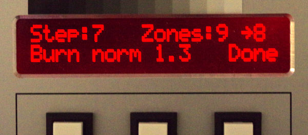

A test strip can also determine burns and dodges. Here's a sample display for this feature:
We are telling the controller, "I want zone 9 on step 7 to print at zone 8," and the controller is telling us that requires a burn of 1.3 stops. This example illustrates burning in sky. Instead of numeric zones on the display, one could display two points on a grayscale as described above.

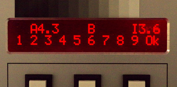

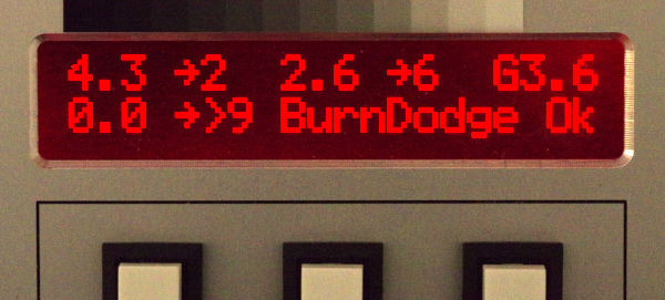

In this display, we are telling the controller, "Reading A shall print at zone 2 and reading B shall print at zone 6." The controller is telling us the grade will be 3.6. The positions and meter readings of A and B are selected using soft buttons and are changed with the knob. A and B can be displayed as points on a numeric zone scale or on a grayscale; the photo above shows both.
Note that the above order is the opposite of the Analyser Pro. In it, you enter the exposure time and grade, and it positions the points on the grayscale. But above, you enter the positions (tones) you want for the meter readings, and the controller tells you time and grade. I prefer the second approach because you are directly telling the controller what you want instead of manipulating settings to yield what you want.
The point "I" in the display is for information. When a meter reading is entered for "I", the "I" moves to the corresponding tone it will print at, allowing you to check the print-tones of various elements in the image on the easel. If you then move the "I" with the knob, the controller shows the burn or dodge needed to print that meter reading at that tone.
The same capabilities are portrayed in the following display that does not use a grayscale or zone scale:
The upper row is saying that "Meter reading 4.3 shall print at zone 2, and reading 2.6 at zone 6." The controller tells us this will be grade 3.6. The lower row lets you enter a meter reading, and the controller tells you the zone it will print at, allowing you to check the print-tones of various elements in the image on the easel. Pressing the soft button for "BurnDodge" lets you enter a meter reading and zone, and the controller will tell you the burn or dodge needed.

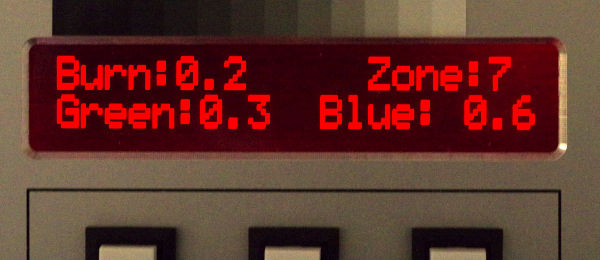

Split-grade. We all love split-grade printing. In theory anyway. The display below breaks up a burn or dodge into green and blue components that will result in the same tone-change.
In this example, we are telling the controller that we want to burn 0.2 stops in a zone 7 area. The controller tells us that is equivalent to a 0.3 stop green-only burn or a 0.6-stop blue-only burn. The amount of burn/dodge could have come from either a test strip or meter readings. This feature makes it easy to create dramatic clouds. When using contrast filters, green is your 00 or 0 filter, and blue is your 5 filter.

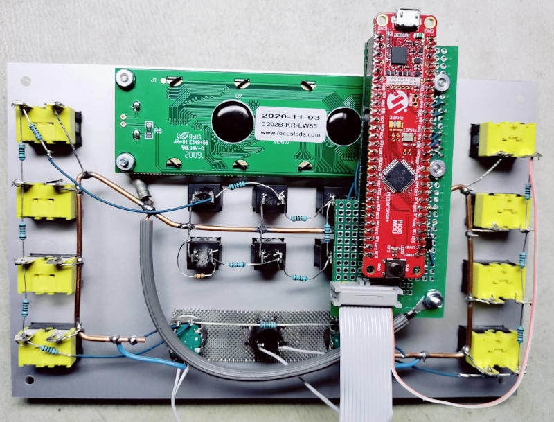

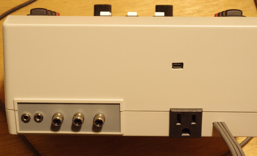

I am curious about the front plate. How did you get the letters on it and how did you cut the holes and countersink the screw holes? It looks very nice !!!!

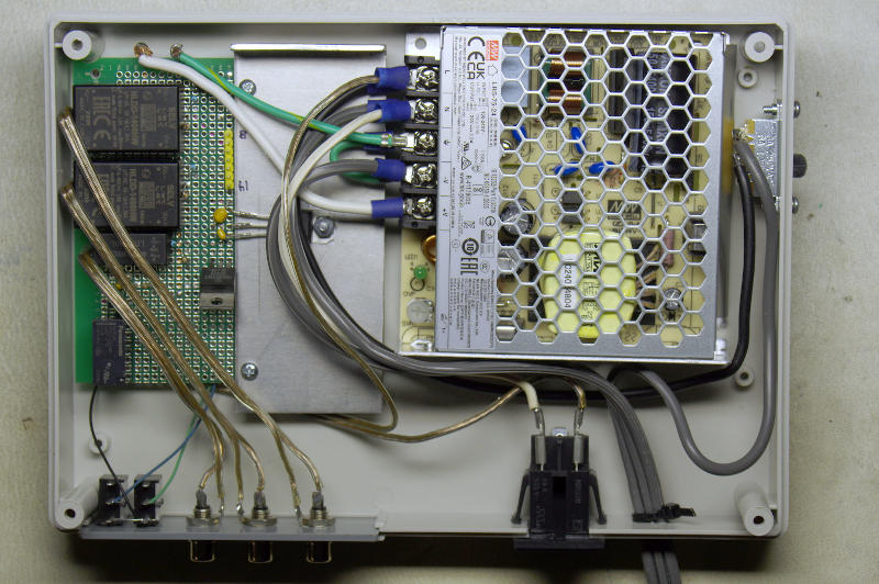

I am curious as to why so many wires come in the back. Is it really just a controller for the LED drivers that are somewhere else? In that case couldn't it just have a single serial communication link to the drivers?
For example the I like working with my existing controllers (for dichroic filter heads) and would probably copy them. They are feedback loop controllers and only have a single cable to attach to the head.
For prototype panels and cases try:
Very high quality, fast service and reasonable prices. I use them for client work. Located in Nova Scotia of all places.
Pre-prototype front panel overlays can be made with artwork printed to RC paper that is then sprayed with Krylon. For slightly less rugged applications an ink-jet print on heavy glossy paper and sprayed with Krylon is perfectly adequate.
DIY 'bathtub' circuit boards with the front panel outline, holes and cut outs as copper traces can be used as the underlay. It gives you precise lines for filing cut outs and precise centers for drilling. I make them as negatives - the boards are all copper foil that is only etched at centers cut out edges; etching goes faster and I don't use up the etchant any more than necessary.
All that is now superceded by using inexpensive laser engravers for the artwork. Get one powerful enough and it can blow holes in the aluminum. But even cheap ones can cut through thin plastic or birch plywood. A wood front panel ... that's a thought.
For my first Printalyzer Timer prototype, I actually used a different company: Front Panel Express
Their quality was also quite nice. But the problem is that they get kinda expensive kinda quickly.
For my next prototype, I'm seriously considering switching over to Protocase. I've even done some initial design mockups in their software, to see how well it would work. At low/single quantity, the price difference is honestly negligible. But once you want to make 100+ of something, it can be significant. (Also, Protocase admits to their quantity discounts while FPE only publishes very modest percentages that don't amount to much.)

I used Front Panel Express. And as Derek mentioned, they are expensive. That panel cost me $130. Ouch! Based on that, I estimate that Derek's Printalyzer prototype case cost $600-700.

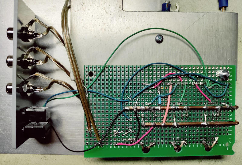

My first controller used the Arduino Uno. The second uses the $20 eval board for the PIC18F57Q84, another 8-bit microcontroller, which worked out well because it's a more modern processor with more flash and four 16-bit PWMs. If I had to do this again, I would look at the Raspberry Pi Pico or other 32-bit microcontrollers.
Here are the wires out the back, from left to right:
Power in​
Safelight out​
R out​
G out​
B out​
Foot-switch in​
Flasher out​
I couldn't find any reasonably priced high-power connectors suitable for the RGB lines, so I just used three RCA connectors. On the other hand, if the high-power LED-drivers were to be moved out of my controller and into the lamp, then a VGA connector could be used for the low-power PWM signals and the flasher LED.
With tax and shipping, it actually only came to ~$470, but that's still a lot. (And that's just the enclosure, not anything that went inside it.)
Of course their prices have probably gone up since then.
Regardless, while acceptable for a prototype, the price needs to be a lot cheaper in quantity for it to make sense for any sort of product. I'm just glad that Protocase is far more open about their quantity discounts, and once I'm trying to build 100+ they give reasonable-enough pricing.

DIY'ers and perhaps Derek will be interested in this: The plastic console case I used is made by Bud Industries, model Plasticase PC-11491. It's the perfect size for an enlarger controller, and the sloped top panel is helpful and attractive. Their website is https://www.budind.com/, and this console case is here. If you click on "Check Stock/Pricing", you'll see prices and stock of their retailers. The typical price is US$20-22 for one, and $13-14 for 50 or 100. Those prices are attractive. But the problem with this case is its rear.
The panel at the lower left is not large enough to accommodate the three outlets we need for mains, enlarger, and safelight. So you must cut plastic as I did on the right, or perhaps cut a large opening and mount an aluminum plate across part of the back with the outlets on it. Either way is kludgey.
The case has two parts: upper and lower. I put all the low power and digital stuff in the upper half, attached to the aluminum top panel. As an inspiration (or perhaps a fright) to the DIYers, here it is:
The ribbon cable brings PWM signals (and a few others) to the high-power electronics in the bottom part of the case, shown below.
The three big chips along the left side are the high-power LED drivers by Mean Well. The vertical "chip" below them is the relay for the safelight.
As you can see in both the top and bottom, I assembled few individual electronic components. Most of the work was hooking chips and components together. Wiring. Mostly wiring. That is not hard work, so I encourage folks to create such DIY projects. If you're interested in learning how to build such electronics, a good place to start is Arduino and its website here. They cater to beginners, so you'll find clear instructions and a community at that site. My first controller was an Arduino Uno, but the latest one used the PIC18 (the red circuit board on top) because I needed more capability and wanted to try something different.
For the the upper and lower circuits, I used perf boards, which are those green boards full of holes (perforations). A producible design would have put all the components, including buttons and such, on one large circuit board under the control panel on top. That's what @dkonigs is doing with his Printalyzer. Maybe I'll design a circuit board someday.
I might as well finish with a helpful tip for other DIYers. Notice the two thick copper wires near the lower-left corner of this photo of the bottom of my high-power board:
These are house wires! Each provides a low impedance path to the power supply so the noise from a chip that periodically draws current won't affect other chips. You still need bypass caps. A second purpose for the thick wires is to transfer strikes of static electricity (ESD) away from the circuitry. I call these two wires the "power and ground rails". In a circuit board, there are usually multiple planes of "printed" wires, and often, an entire plane is devoted to ground and another to power. These ground planes and power planes serve the same purpose as my rails. I asked an experienced EE at work about my rail approach, and he agreed with it. In fact, he said he's done similar things in the past.
A bad design would be to daisy-chain the ground and/or power wires among chips. An EE did that at work many years ago, and I had write the firmware to get his circuit board working. That was an adventure. The company fired him, and had a competent EE take over the design. And I learned a lesson: Make certain your ground and power rails/planes are solid!
A final clue: Learn about TVS diodes/arrays, and use them to protect your circuit from ESD strikes. Those diodes shunt those zaps onto the ground/power rails where they won't hurt anything.
BTW, I am a software geek and not a EE, so EE's here are encouraged to correct me.
Mark
While an off-the-shelf case may have its benefits, by the time you've made the necessary custom top and rear panels you haven't saved quite as much as you think.
But as far as designs in general, I know the "sloped console" one does look nice on the surface. But it has one big problem from an assembly/internal-design point of view. You can't use the circuit board from the top panel to mount any of the front or rear connectors. So if any of your connectors are board-mounted, that means a minimum of 3 PCBs to make it work with front and rear jacks.
The first prototype of the Printalyzer Enlarging timer actually attempts to fit everything (panel, rear connectors, front ports) onto a single PCB. Of course now that I'm getting started on the second prototype, I've decided to split off the rear ports into their own PCB. Two real reasons for that... 1) To isolate everything that has to touch mains AC into its own board I can update/finalize independently. 2) Because it actually lets me reduce the case depth a bit.
I've definitely gone overboard with TVS diodes in my designs, just to be safe. The most frustrating part with them, is actually finding single-line TVS diodes that aren't damn near microscopic. I'm now on the 3rd choice of diode with my various densitometer project PCBs, each time increasing the size a little, and they still look like specs of dirt when you look at them on the table without a microscope.
