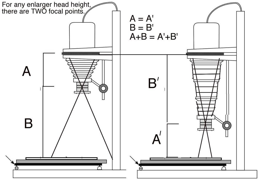

For any enlarger head position there are two focal points for the lens (two bellows positions). One position for enlargements and another for reductions. In one case raising the head and re-focusing causes the projected image to get bigger and in the other case raising the head and re-focusing causes the projected image to get smaller.
