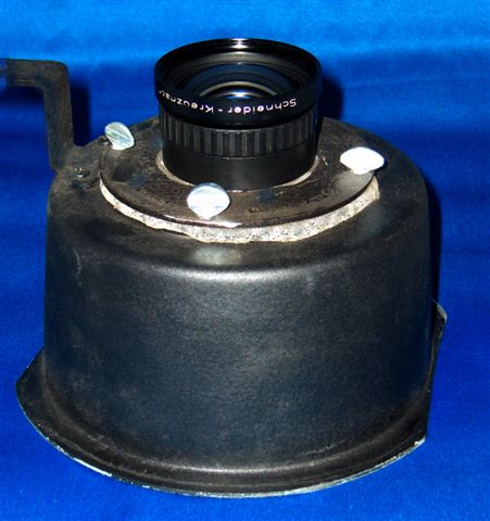

I have found my Omega D2 to be very easy to align but my Beseler 45V-XL not so easy. I noticed that another poster here mentioned that they have a hard time aligning their lens stage with the D2. I have a tip. Remove the ring that the lens mounts to. Then cut a donut of the material that mouse-pads are made from and punch holes in it that align with the screw holes in the ring. Then reassemble the ring onto the cone with the rubber donut in-between the two parts. Then screw it together using Allen heads or, better yet, thumb screws. Now, to align the lens stage, you simply turn the screws. Works beautifully! I use a laser alignment tool
LOL! I see that someone else mentioned my solution here. Great minds think alike. I wonder if he read it in a thread I may have written previously.
I'll attach a picture of one of my cones with this modification.

Sorry for the double post. I didn't think I had already posted it when I stopped to take a picture of the modified Omega setup.
A fine point: You can, of course, use three screws. That will allow you to do total adjustment in the two planes necessary. But the lens rings are originally screwed on with two opposing screws so it's an easy matter to simply drill two more at 90 degrees to those. I did modify one of my lens setups using three screws and it works fine but I found that I like the four-screw setup better.
With either two or three screws, it works so well that I wonder why Omega didn't think of it. I thought of it the very first time I used the enlarger decades ago.
