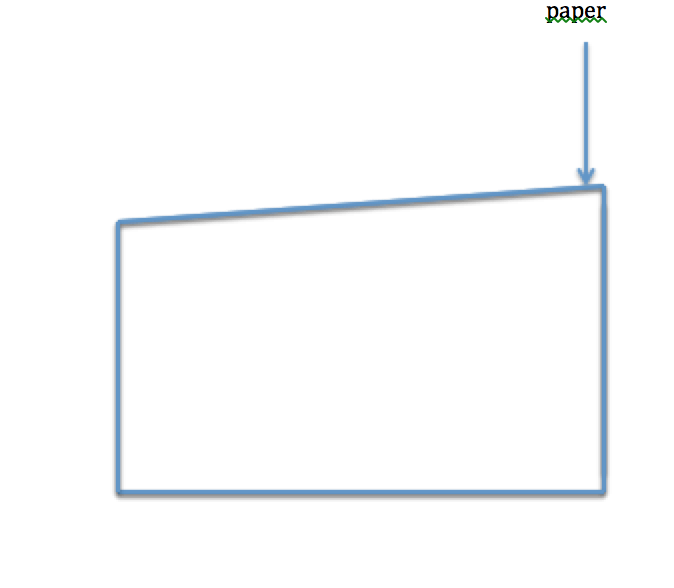

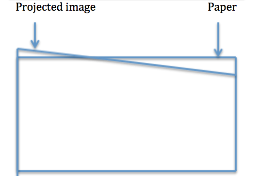

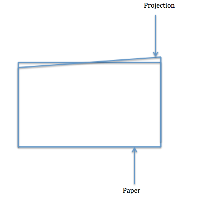

1st. What I mean by crookedness is when the image is projected I can take a test sheet 8x10 paper and am unable to have it straight. I will include a screen shot of a diagram of what I mean in the attachments. I’ll put a number for when I am describing each diagram. Diagram 1. In the diagram it does appear that just tilting the paper on the base would solve this, but when the paper is moved the other size becomes crooked as well. I have determined that one side of the projected image is larger then the other. See if I adjust the paper like so Diagram 2. The projection over the paper will now look like this Diagram 3. I don't understand this phenomenon, and if you need any more clarification on that point let me know.

If the head on this enlarger can be tilted to project on the wall then make sure the tilt is set to zero.

My guess is the enlarger head is tilled in 2 directions . You need to see if can shim the paper easel in 2 directions until the image is square. There were enlargers made with a tillable head so that out of perspective buildings could be printed with a correct perspective. When adjusted the full image would not be square so you cropped not so square boarders were cropped out.

Also if the negative stage has adjustable cropping blades, are they set correctly? i.e. each blade is parallel to its opposite blade.
If you can put a neg in carrier which has a straight line along one edge, then does that edge project on a slope or horizontal ? i.e. is it the neg which is being cropped into that shape or is it being projected into that shape?
