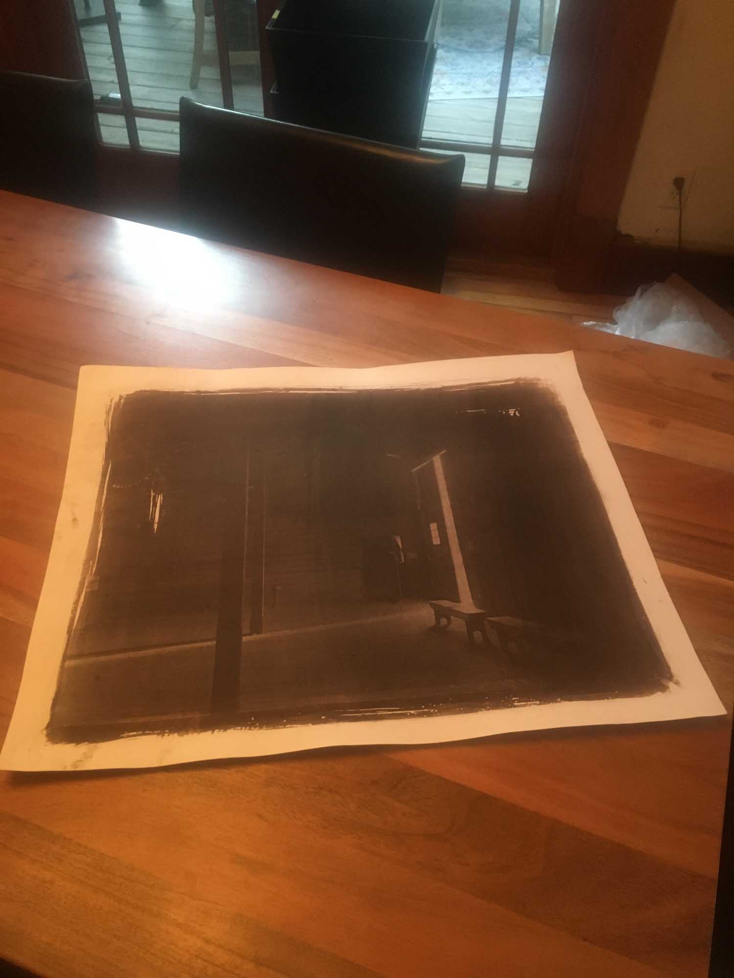

This print I made yesterday has good density in the shadows, but the highlights are a bit dirty. I'm not sure exactly why that is, I think my gallic acid may have been contaminated with some silver nitrate since I had been using it throughout the day prior to making this print.

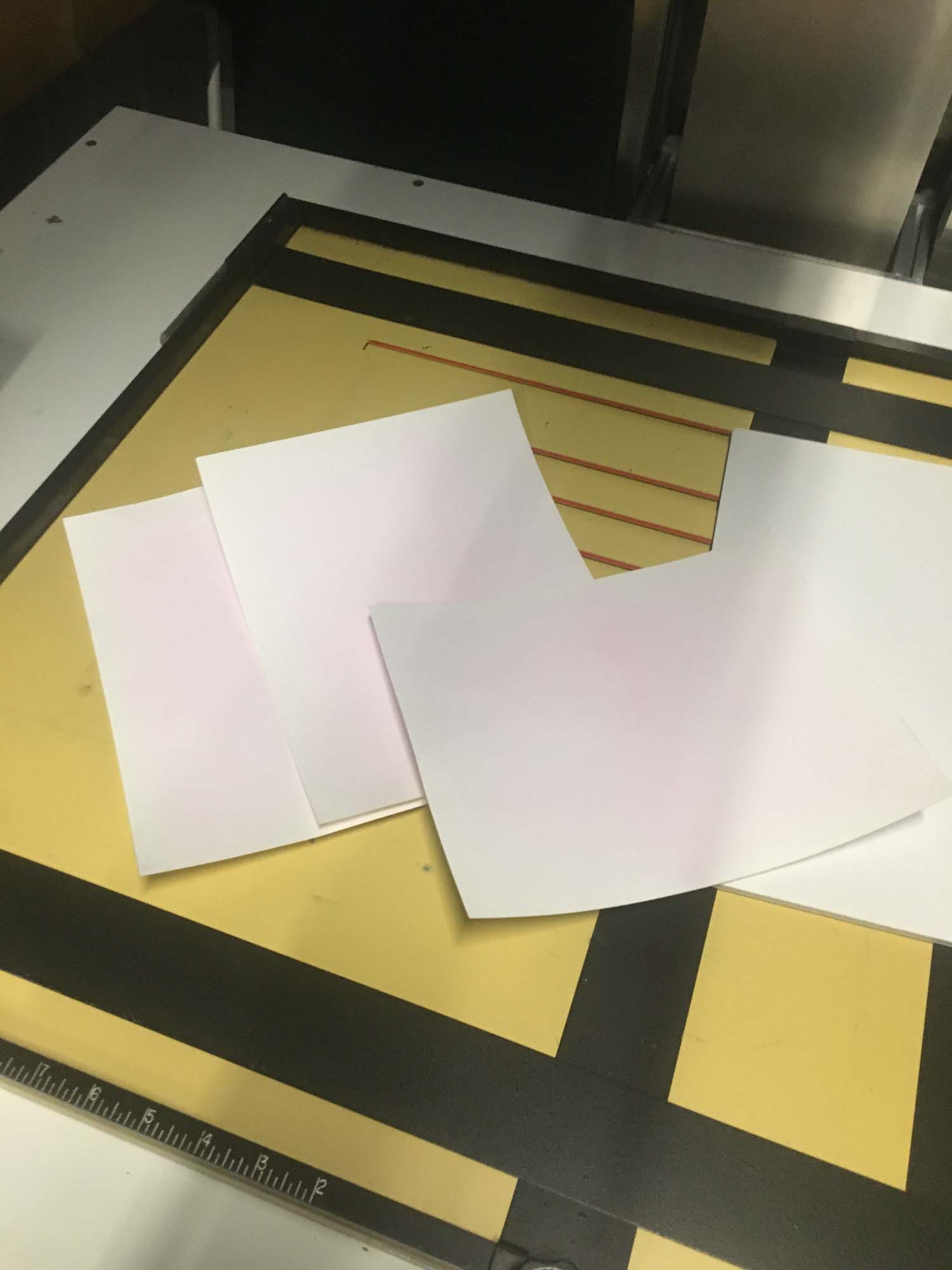

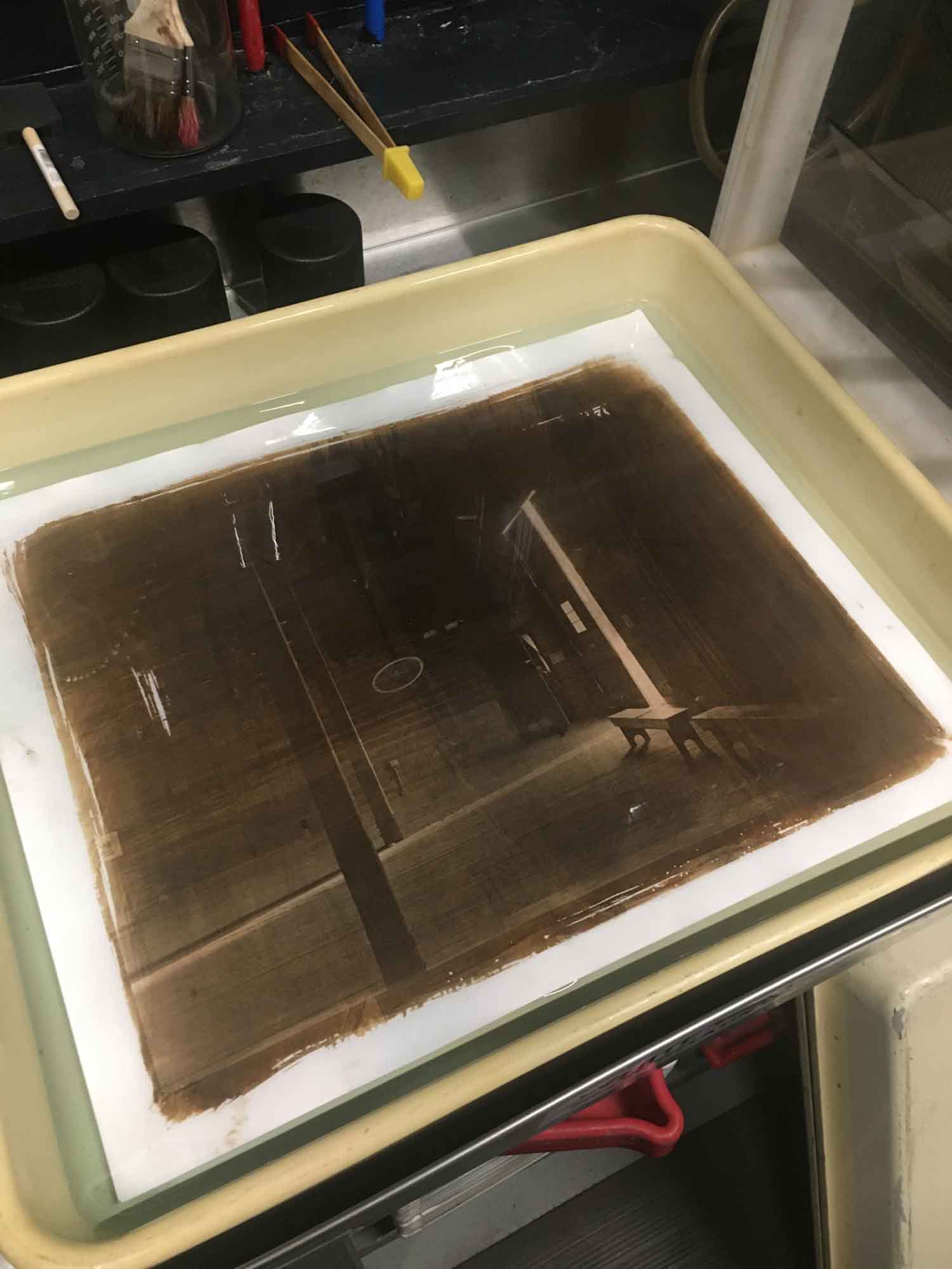

The process to create this image was as follows: Float paper on a solution of 2% ammonium bromide and 0.2% gelatin. Once dry, coat with erythrosine solution so that the erythrosine measures 100mg per mole of silver in the silver nitrate which will be used. Then, under a safelight since the process is visible sensitive, coat with 15% silver nitrate. Expose under an enlarger until the image is faintly visible. Brush a 1.4% solution of gallic acid over the print so that it completely covers, and wait a few minutes, if there isn't enough density, brush more over it and wait some more. Keep doing that until you have the tones you want. Then, fix and wash as you would a normal salt print.
Here are some images of the process, the first is the finished print, the second is erythrosine coated paper, the third is the print exposing under my enlarger, and the 4th is the print in the fixer remover bath.

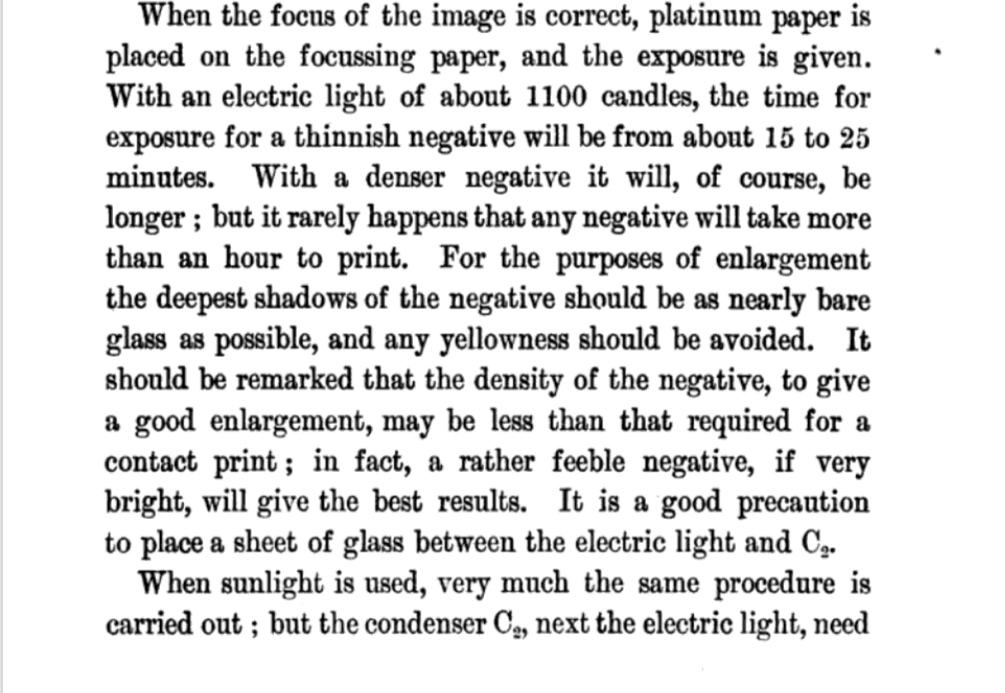

I've just checked Abney text, he says that with 2 condensers and 1100 candel carbon arc x2 enlargment of quarter plate exposure should be around 15-15 minutes.
