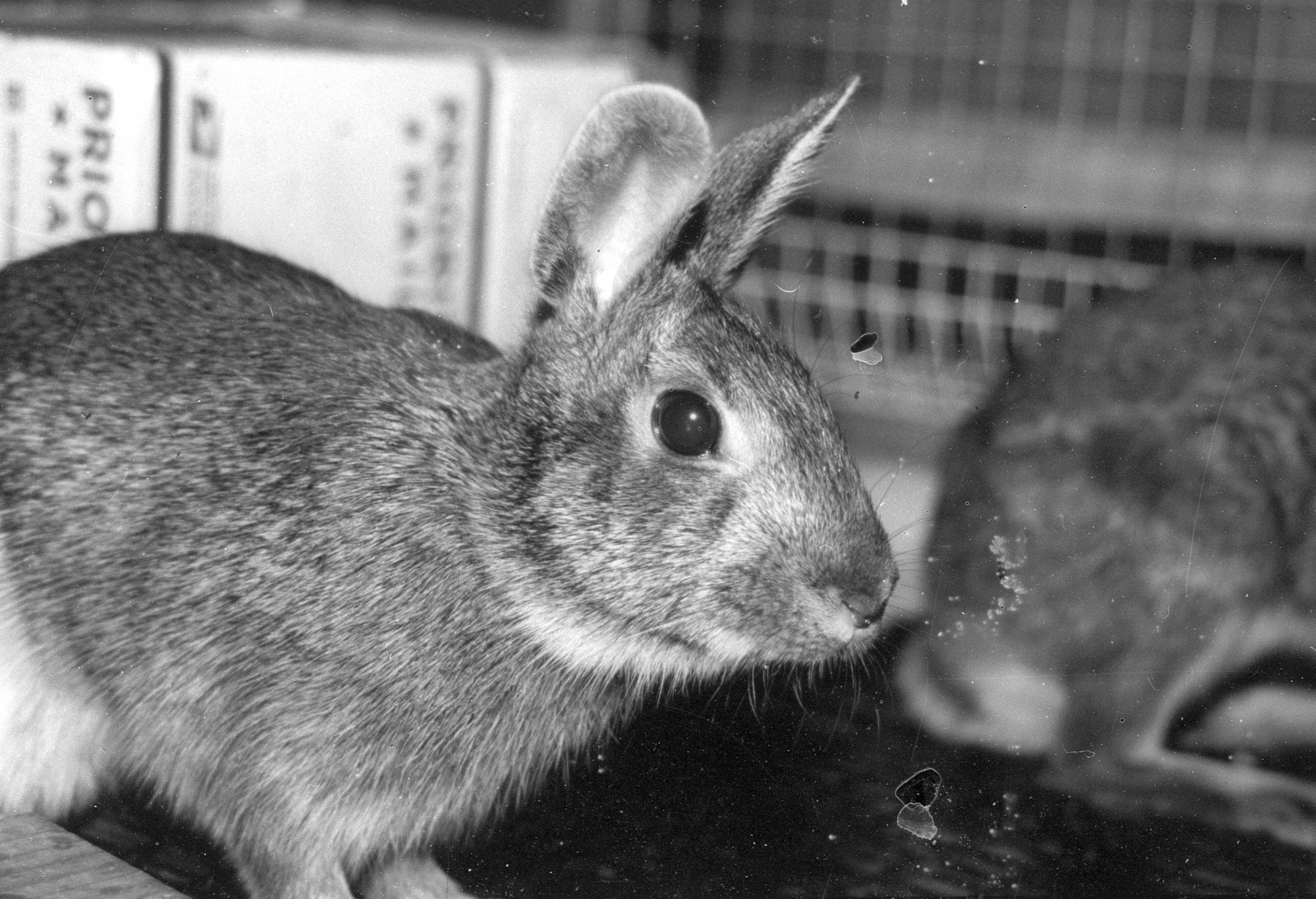

Hi PE,
That batch was right around ISO 25. It had minimal sodium thiosulfate sensitization. I am working on a run now that is closer to 40 with thiosulfate @ 100mg / mole Ag. Samples cut from selvedge below, the first is straight as exposed for ISO 25 (overexposed) and with Levels applied.
Last night I sensitized the second half of the run with Sodium Thiocyanate at 50 mg / mole Ag. Haven't coated any of this one yet. I used thiocyante to try something different.
Caroline (the rabbit) at least makes an agreeable model!
No gold sensitizing tried with this emulsion yet. BTW, these are not plates but 35mm film negatives. The 120 negatives look really great - I have to get some printed.
