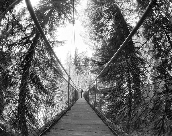

Bump (and a few pics). Handmade film, Pentax 67, 35mm fisheye lens, at Drift Creek Suspension Bridge, Lincoln County, Oregon
